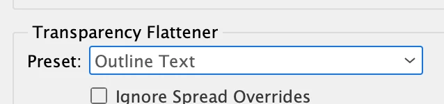

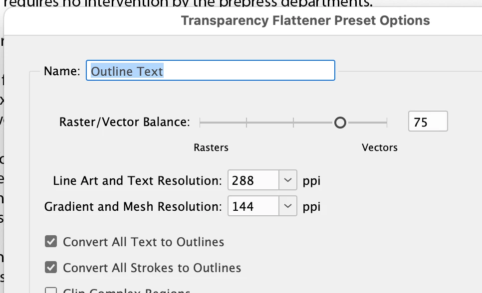

There's an obscure way to do this:
Create a transparency flattener preset with Convert All Text to Outlines checked, then select this preset in PDF export settings:
Other than that I agree that that it's not a desirable workflow.
As far as I understand this was the method used by OP. Although I'm not exactly sure why it stopped working for him (which seems to be the problem he's trying to solve).
