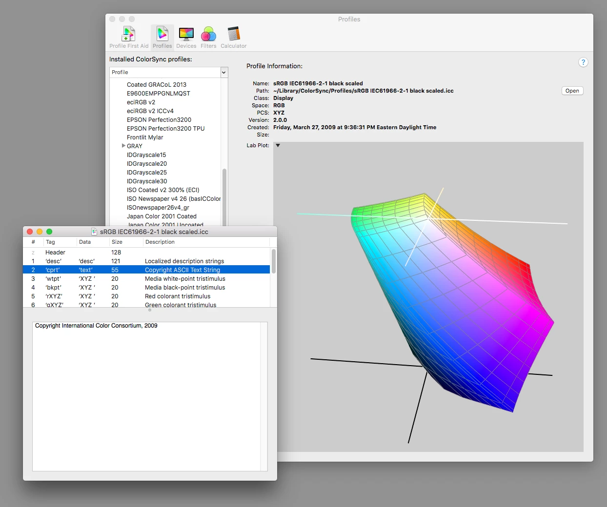

Where does this profile come from?
OSX's ColorSync Utility shows the copyright as ICC
ColorSync Utility has a very useful Hold for Comparison feature which let's you see a visual comparison between two spaces and comparing sRGB IEC61966-2-1 black scaled with Adobe's installed sRGB IEC61966-2-1 shows no difference, so I think you can safely reassign the installed sRGB.

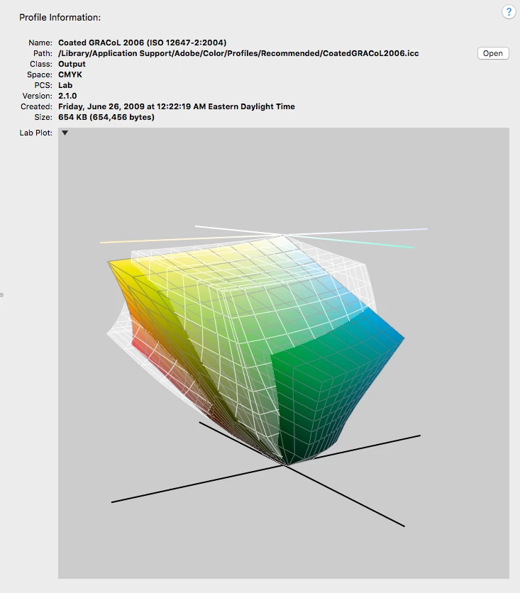

If I compare sRGB with a typical coated offset profile like GRACol 2006 you can see the problem with editing in sRGB for print applications, a very significant chunk of the blue green spectrum gets clipped. Editing in sRGB would not allow you to get to this part of the CMYK gamut without first converting to CMYK and making post conversion edits:
