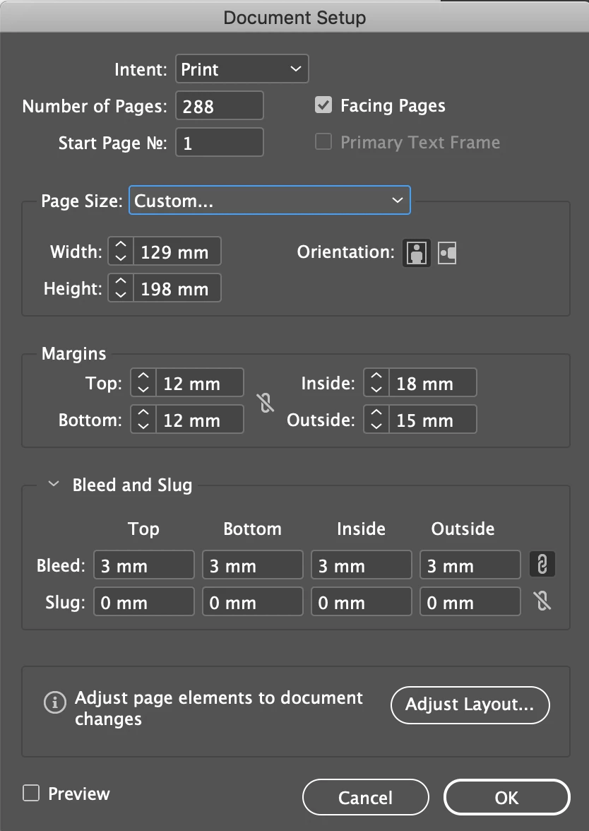

I've recently created documents 198 x 129mm - intended for book printers.
When I export the Indesign doc to press quality pdf, the resulting pdf is set to A4, and does not reflect the 192 x 126mm size of the document.
This never used to happen, and I don't know what's changed, or what I need to do to get the export working to the same size as the INDD document.
And how to check the size of the pdf in advance of the printer telling me it is set to A4.
Any help or ideas very much appreciated!

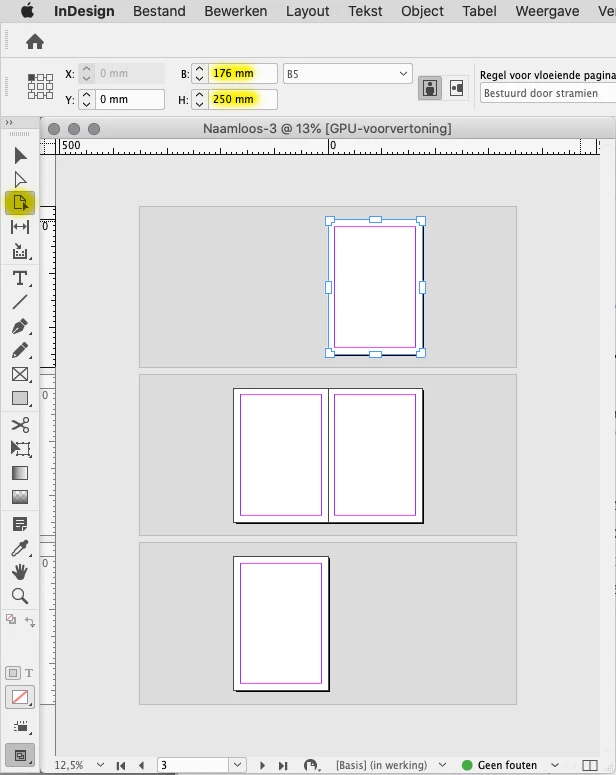

Your Document Setup might be set to some custom size, but pages can override this ! So I wonder if the actual page(s) are that intended size. Maybe you or some one else switched the size of one or more pages (or even the Master Pages) to a simple A4 size, resulting in this behavior ? Check this out, by using the Page selection tool:

You have 3mm bleed, if you are including bleeds in the export, the PDF page dimension should be 135mm x 204mm—and including slug or marks would further increase the dimensions.
Also, you can customize the page sizes with in a document, so the InDesign Document Setup doesn’t necessarily give you the page dimensions—check the actual page dimensions via the Info or Transform panels by selecting a page with the Page tool.

Thank you for your help. The INDD document set up looks like it is set to the correct 198x129mm.
When you mention setting the size of the document in preferences, do you mean in INDD or in Acrobat? What section would I look under for checking that? I only have Acrobat Reader, if that makes a difference.
Again, thanks for your help.
