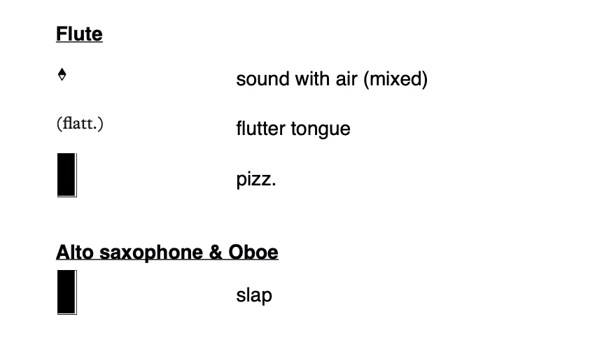

The issue: upon assembling the InDesign document, I exported it to PDF using the Press Quality preset. I checked every file in Acrobat and it looked fine, yet the composer reported that, upon opening the PDFs in Preview on macOS 12.3 (same as I have been using), he would see black boxes over a couple of glyphs:
Originally these glyphs were created in Sibelius, and exported as selected graphic in SVG format (I didn't know how to use Illustrator in 2019 to do this more efficiently). The attached PDF is the resulting PDF exported from Pages, and it opens well in Preview. Placing it with the File > Place command in InDesign results in correct drawing onscreen, but with these black boxes on Export.
I have no idea what is happening here and I would really appreciate if someone could help me investigate what is happening: to reproduce the issue, create a new InDesign document, create a parent page with a graphical frame occupying all of it, create a total of 2 pages in the document, place the attached PDF in those two pages and export it as PDF using the Press Quality preset. Open it in Preview and tell me if you also see the black boxes.

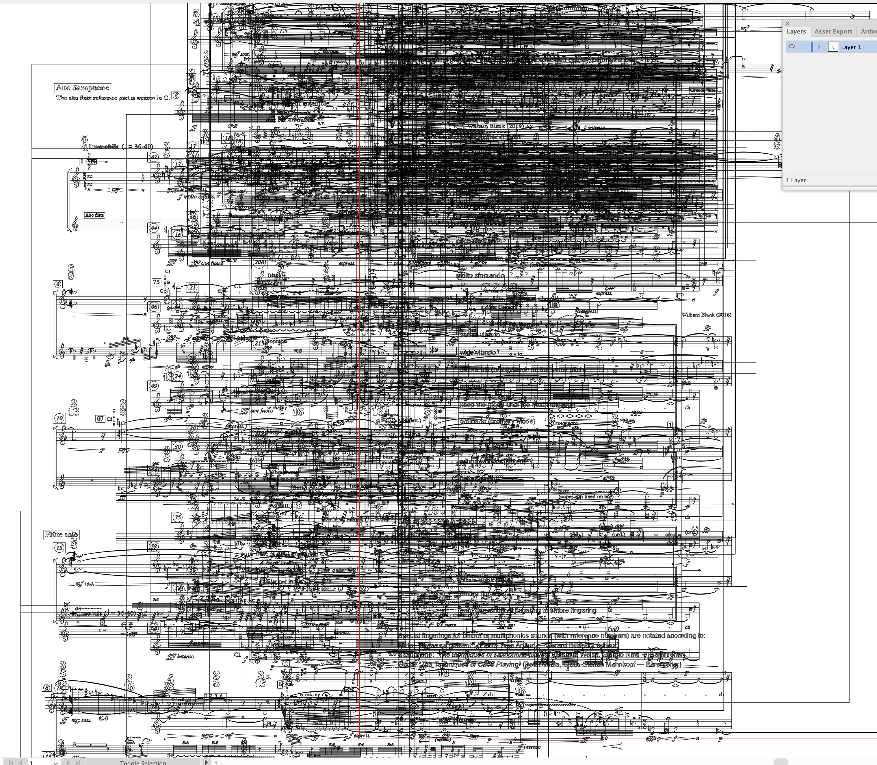

I opened it in Illustrator to get a sense of the structure of it (actual procedure: PLACED the file, then Flattened it (Object > Flatten Transparency, selecting High and convert fonts to outline), and it's such a complicated file that I'm not surprised it failed.
Each of your note graphics is a cropped image from a full sheet of score.. many many many times. and each crop has a few clipping paths/and or masks
This is what it looks like in outline:
 If you want a quick fix this to this file right now, Open your PDF and Export To > EPS (Encapsulated Postscript), selecting Level 3 and embedded and referenced fonts. Place the resulting files in ID and PDF the file. Not only will it work, it will be a fraction of the size.

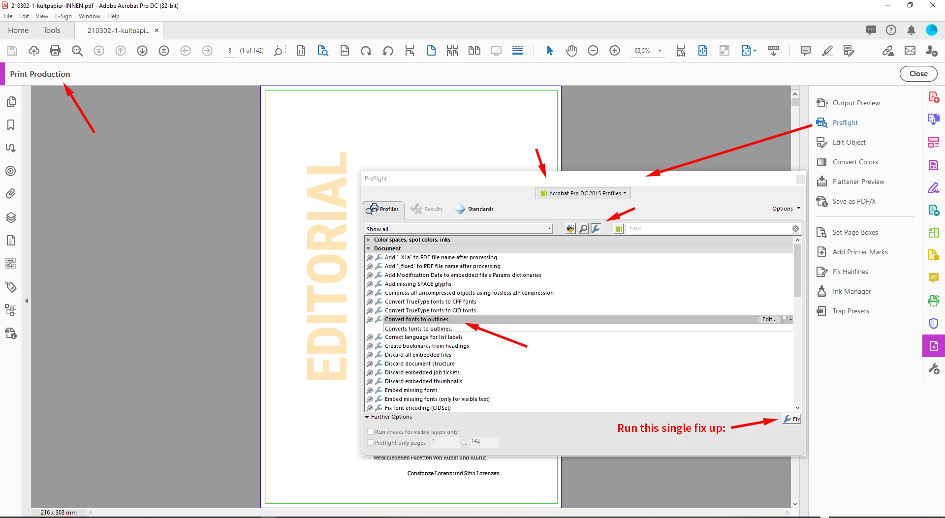

Hi Inélsòre,
to work around the issue you could convert all fonts in the exported PDF to outlines using Acrobat Pro:
FWIW: I cannot see an issue in your provided PDF. Even the PDF reader of my Firefox browser is able to render the pages without flaws. Or the preview of my Windows 10 machine in the file explorer.
