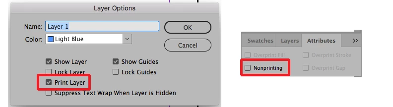

    Bill SilbertCorrect answer
    April 4, 2019
    You can check a couple of places within the file. First double-click on each layer in the layers panel (Window>Layers) and make sure that "Print Layer" is checked for each layer. Then you can also check the Attributes Panel (Window>Output>Attributes). To use that panel select all items on the page and make sure that "Nonprinting" is unchecked in that panel.

    April 4, 2019
    Thank you very much, Bill!!! That's exactly what I had to do.

    Bill SilbertCommunity ExpertCorrect answer
    April 4, 2019
