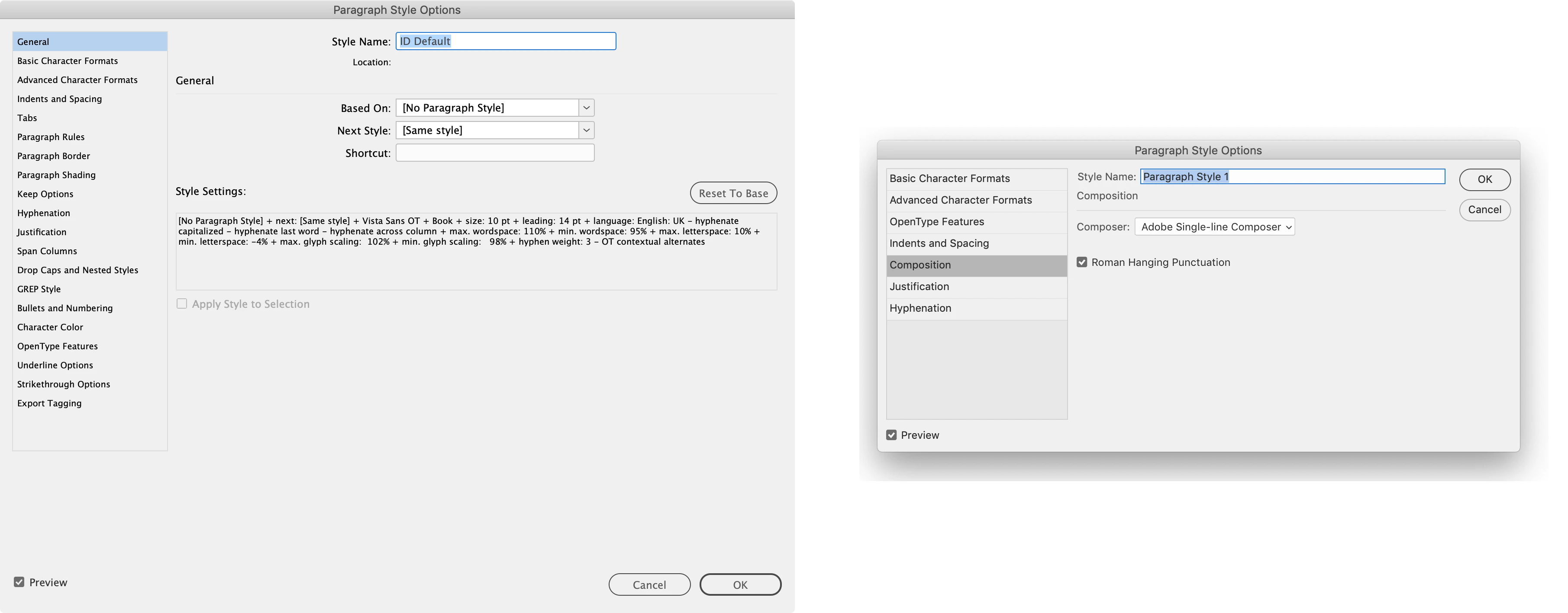

It might be possible to script a transfer of Photoshop text properties to an InDesign Paragraph Style—Photoshop has a .textItem property for text objects with its very basic style properties—but going the otherway would be next to impossible. There’s a huge difference in type setting capabilities between the two apps. An InDesign Paragraph Style has 300+ properties while a Photoshop style has less than 50:
Going from PS to ID how do we handle Roman Hanging Punctuation? (InDesign has Optical Margin Alignment but no hanging punctuation)
