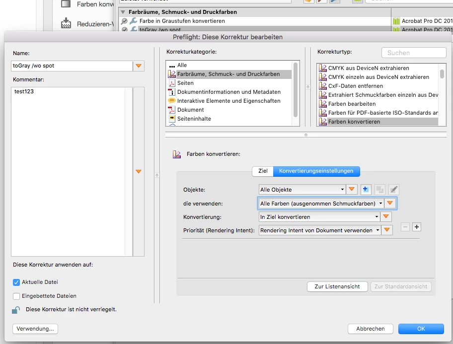

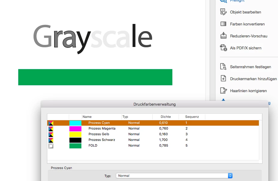

i couldnt mimic the actual pdf-process of yours, because my InDesign-Install hasnt the pdf-profile to grayscale at all, maybe a german client thing.
But, maybe this could be an approach:
Open Acrobat and take a look at Preflight. There is a default preflight profile to convert all colors to grayscale. If you duplicate that profile and change the settings (target: correct the desired grayscale-profile; next "tab" get rid of action 1 "all object not gray", and change the second from All Colors to All Colors without Spot) you can convert to grayscale and leave the spot.

Thank you mate, I was considering that option as well but I was more focused on being able to do it from Indesign but due to the lack of alternatives, I'll go through your suggestion.
