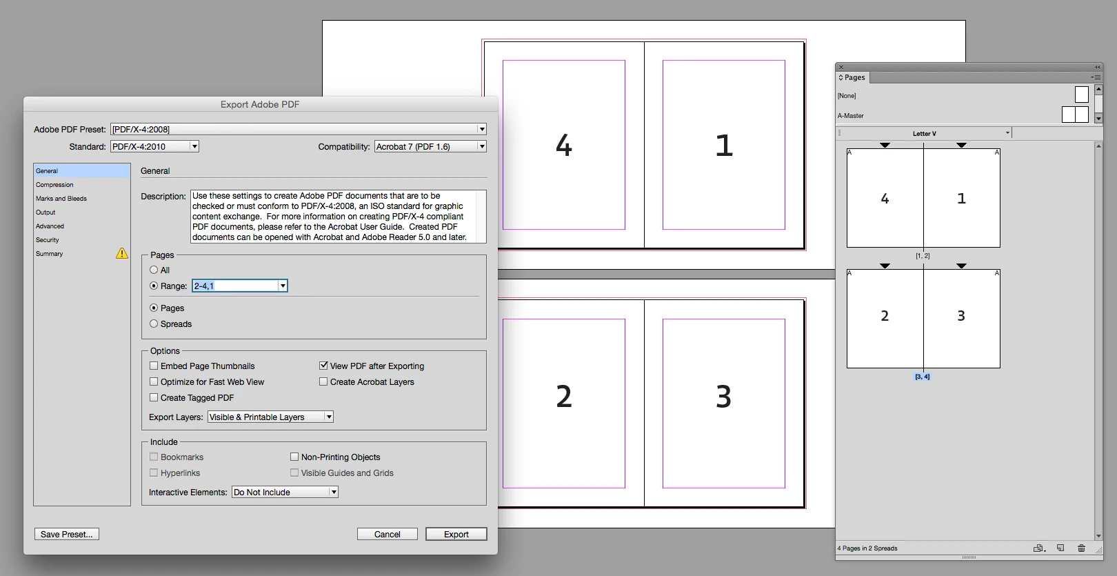

Hi everyone,
this is the setup I have in Indesign.
I need it to export like this: first page as cover page, second and third page as spread, last page. I did achieve it with exporting and combining inside Adobe Acrobat Pro DC, but I want to know if it's possible to achieve directly with InDesign or some script.

    rob day
    March 15, 2017
    RANGE: 1, 2, 3, 4
    I think the range would have to be 2,3,4,1, or 2-4,1.
    rob day
    March 15, 2017
    But why set the document up as printer spreads? If you setup as regular facing page reader spreads, you can use either InDesign's or Acrobat's Print Booklet to output the printer (4,1) (3,2) imposition and export the same doc as reader spreads with a regular export.

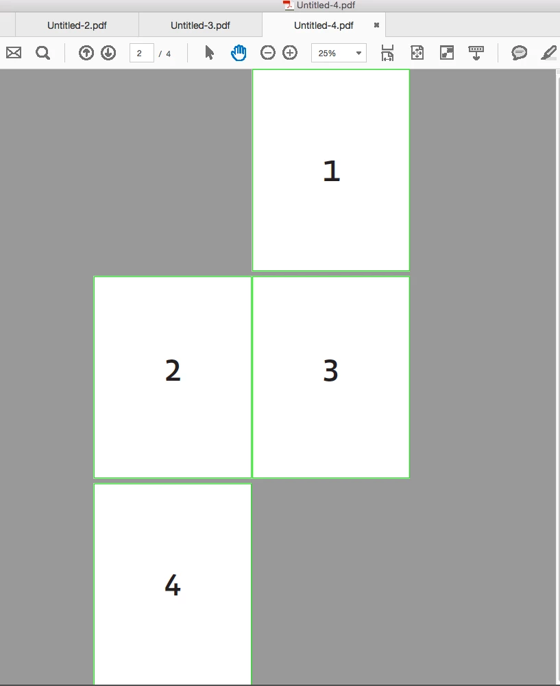

    Jeff Witchel, ACI
    March 15, 2017
    To expand on Barbara's answer, after you have page 1 and page 4 in the correct positions in the Pages panel, go to File > Export and choose PDF Print.
    In the general section of the Export dialog, check Spreads and Save. In the Acrobat, you'll have page 1 by itself, pages 2–3 as a spread and page 4 as a single page.
    Barb Binder
    March 15, 2017
    One idea: make a copy of the file, and then drag the pages in the InDesign Pages panel into the desired order of 1–4. Export to PDF. In Acrobat or Reader, choose View > Page Display > 2-Page View and View > Page Display > enable Show Cover Page for 2-Page View.
