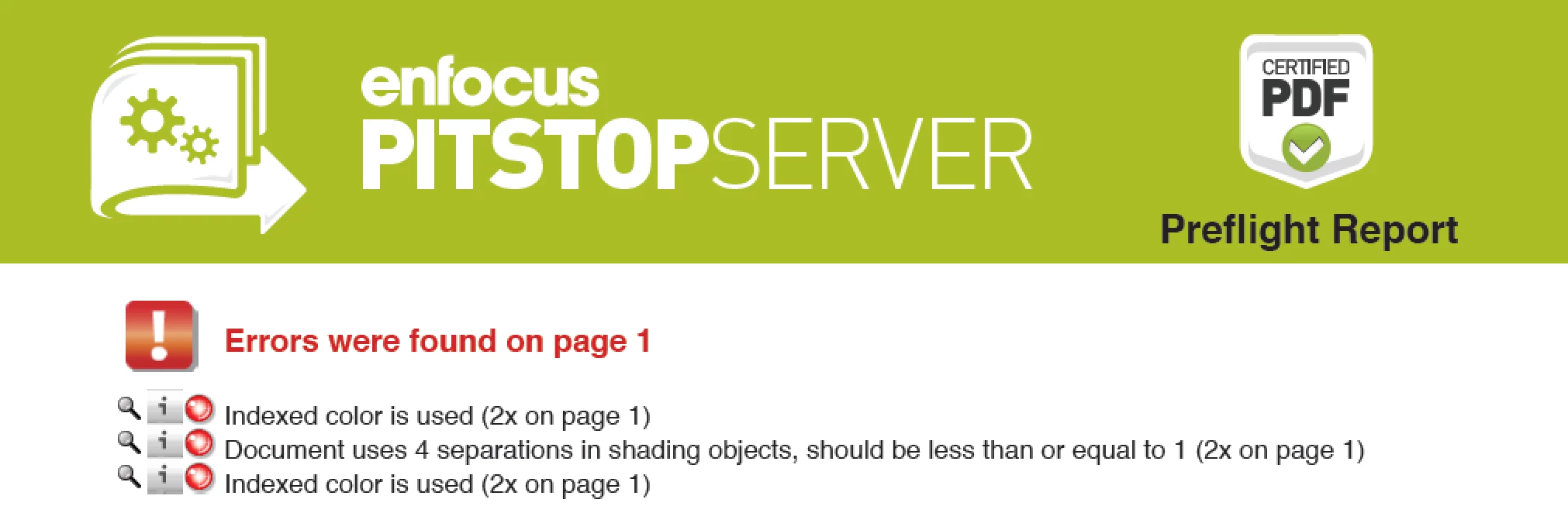

We use the drop shadow option for frames in single colour (B/W) files, but when we exported the pdf using the PDX1a setting, the Index colour automatically appeared in the PDF. Can anyone suggest how to resolve this issue.

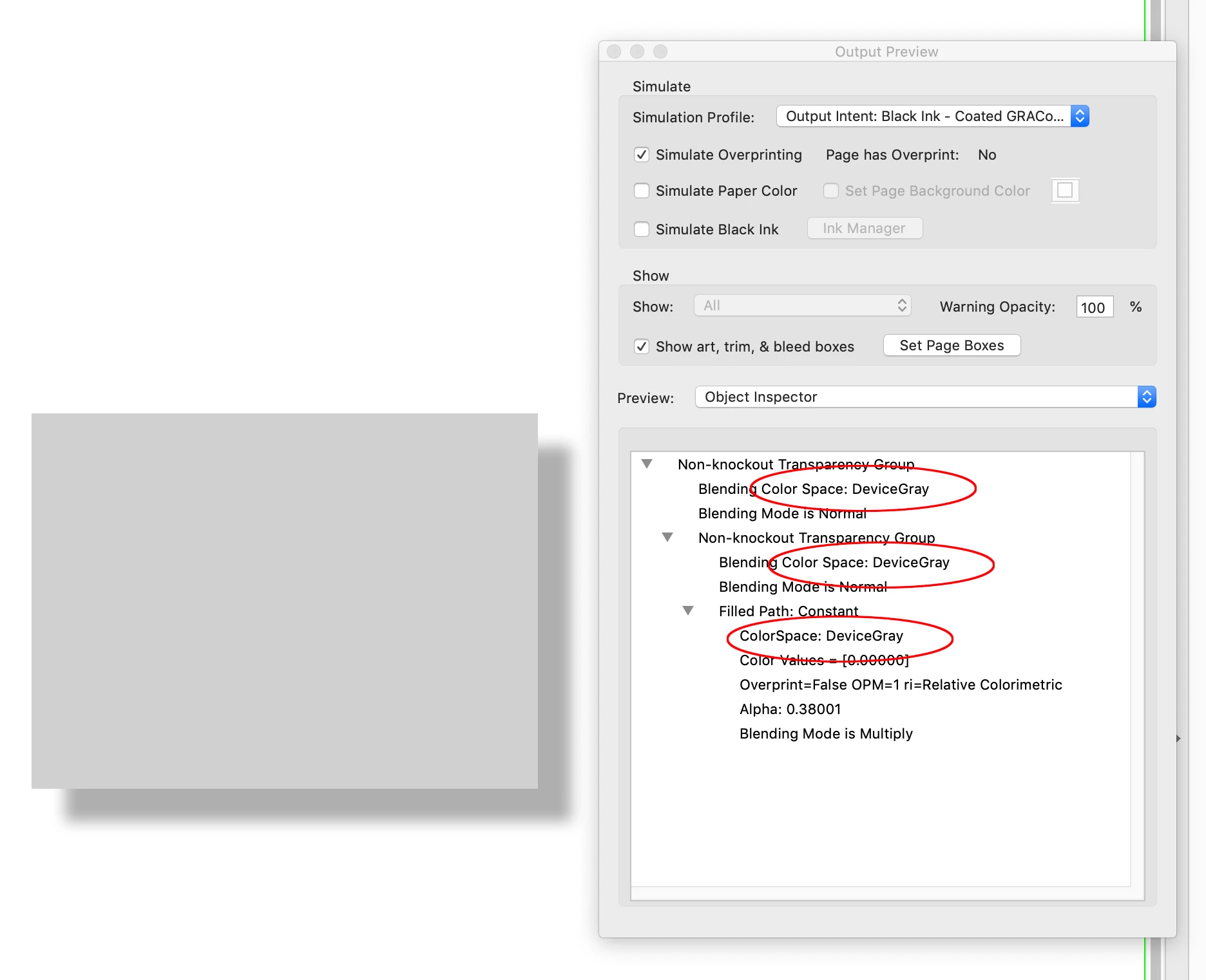

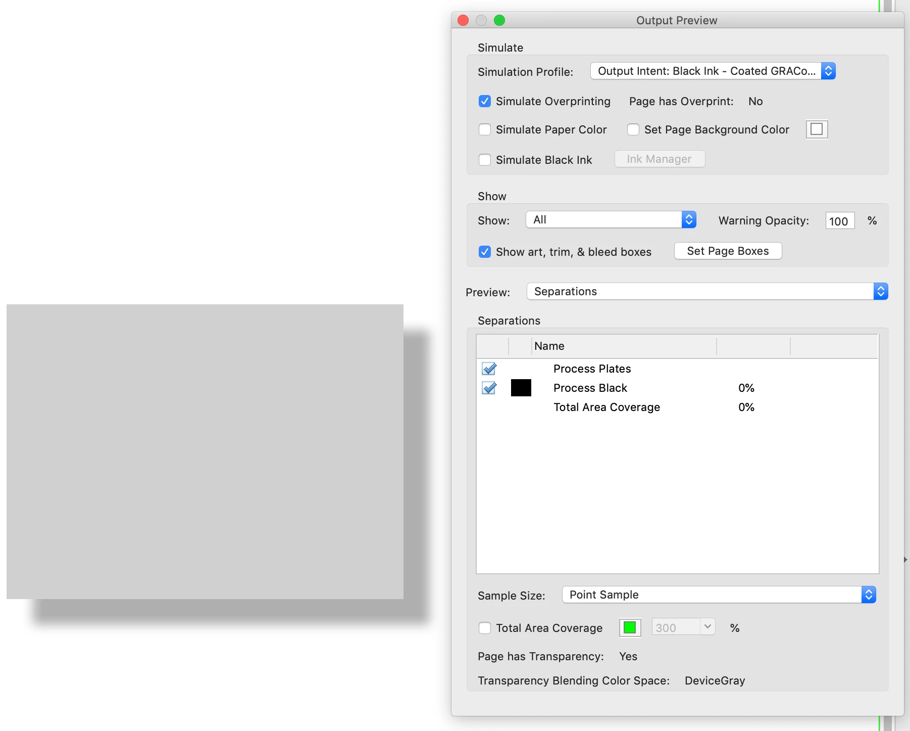

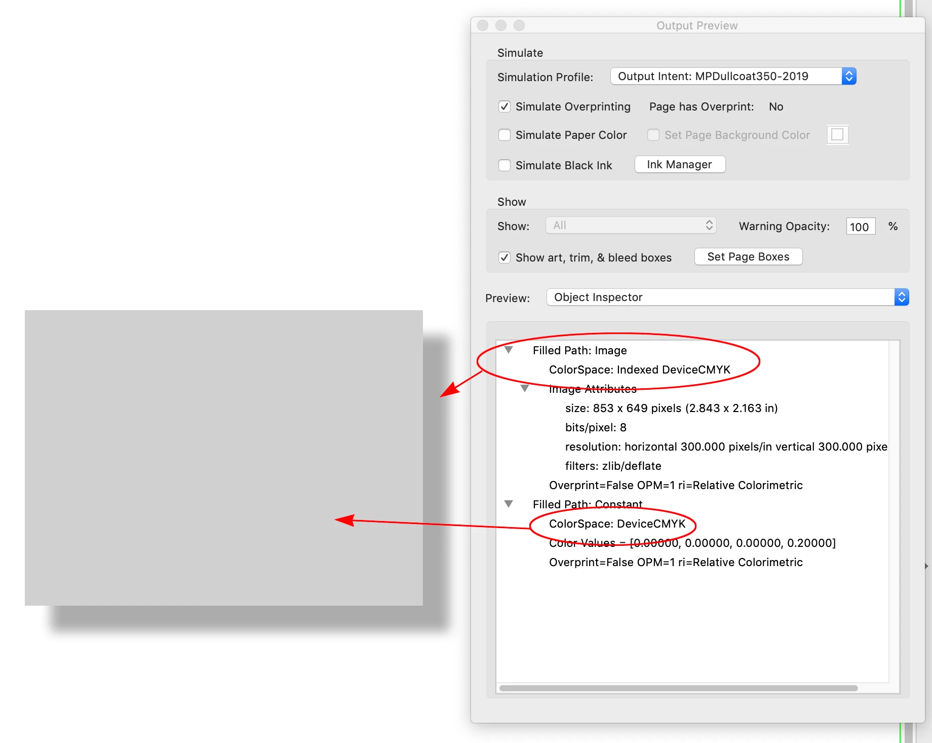

Hi @Test Screen Name , Also, the index color is a result of PDF/X-1a’s flattening— a drop shadow gets converted into a DeviceCMYK index color image when it is flattened. Filled paths export as DeviceCMYK:
A PDF/X-4 exported to a Gray profile probably passes @Ilavarasan B ’s preflight—no index color and only 1 plate:

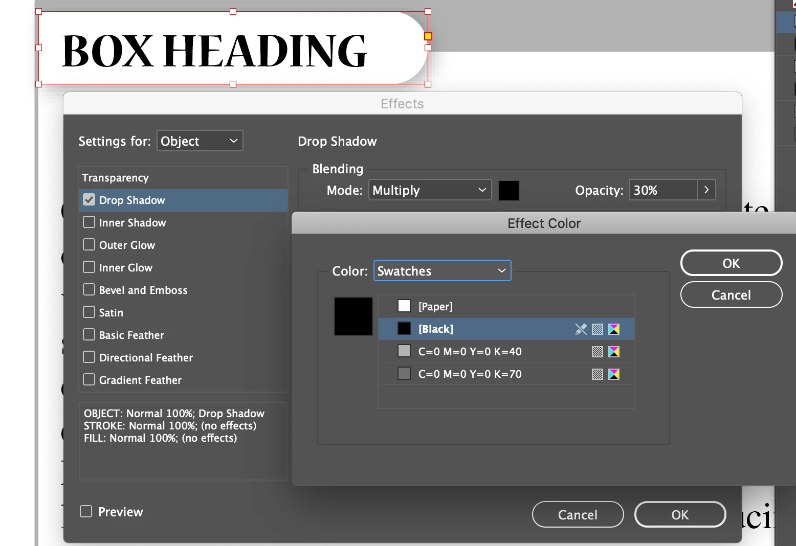

Hi @Ilavarasan B , The PDF/X-1a Standard requires that all color be either CMYK or Spot—the Output Destination profile list is limited to CMYK profiles when the Standard is set to PDF/X-1a. You have set your drop shadow color to the default [Black], which is a CMYK color with CMY set to 0.
The PDF/X-4 Standard allows Gray profile Destinations. You could export to PDF/X-4, and if live transparency is an issue, flatten the PDF in AcrobatPro.

why does the preflight profile in Pitstop makes an issue, even an error, out of an indexed color?
Indexed colors in PDFs are just like "normal" colors; just encoded more space efficient. Nothing to worry, I think.

But it also seems to indicate a 4-color shadow, unless I'm misinterpreting the meaning of shading object...
