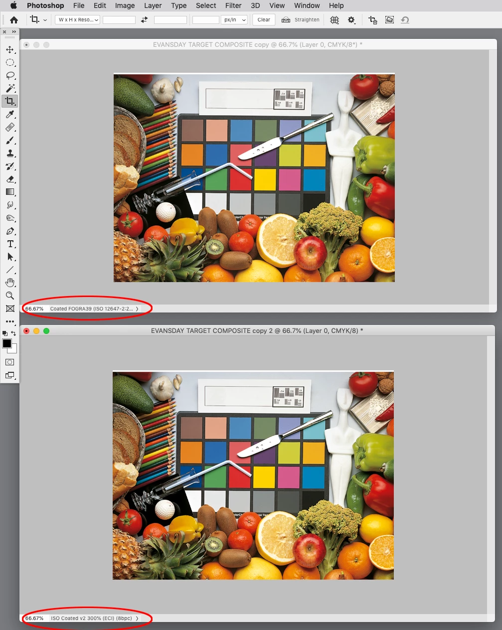

rob day
May 1, 2021
The output CMYK color appearance using either profile is virtually identical—Fogra 39 allows more total ink at 330% vs. 300%. Here’s the soft proof of Fogra39 (top) and ISOv2 (bottom):

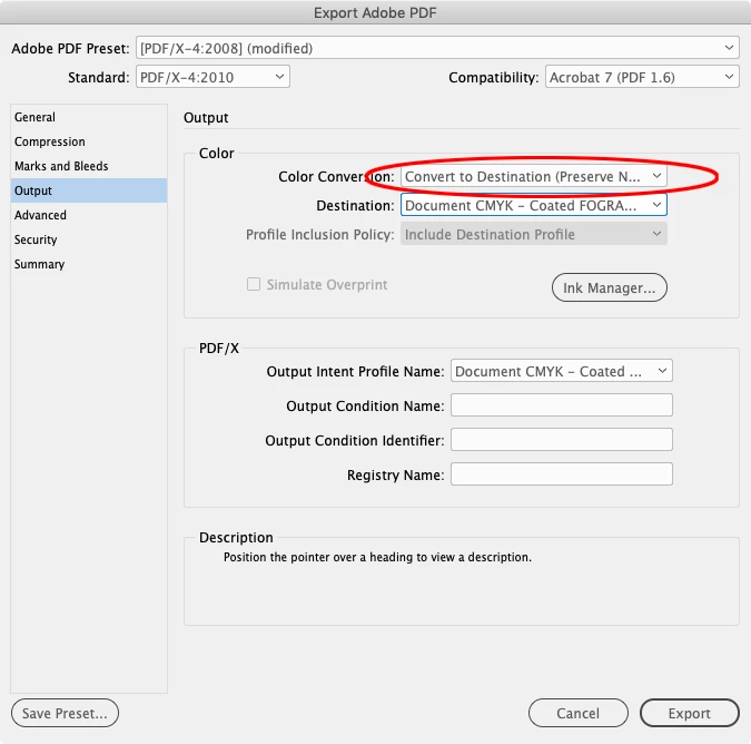

So if you make sure all of your placed images are edited in a large RGB space (i.e. AdobeRGB) and saved with an embedded profile, you could assign the appropriate CMYK profile to the InDesign document before exporting (Edit>Assign Profiles).
By default PDF/X-4 uses the document’s assigned profile as the Output Intent. On Export you could choose to convert RGB color including placed images to Document CMYK, and protect built document CMYK swatches by setting the Conversion to Convert to Destination (Preserve Numbers). Or you could do no color conversion and let the printer convert the RGB images at output and assume they will use the Output Intent profile:
