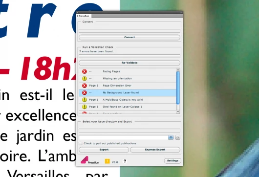

You may as well build your own UI. Circa 2009, I worked with a digital publishing solution and we created a UI assistant that will let the designer know the possible issues in his document.
As preflight is scriptable, you could still use preflight reports and append your own preflight routines and introduce the final report to the user in your very own interface.
