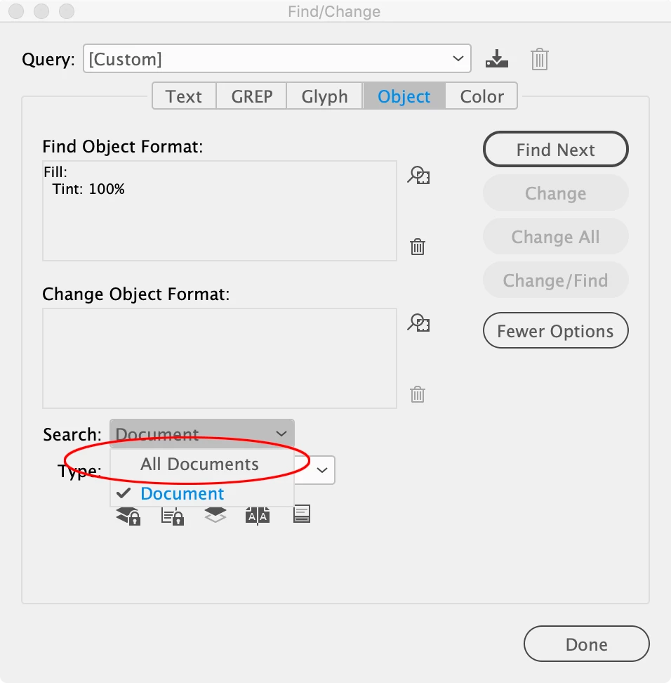

Hi Mark,  I’m seeing the same behavior with CC2021. I’m not sure it‘s a bug? In the findChangeObjectOptions there’s no property for searching all documents, so I think that’s why activating the document in your documents loop works:
I don’t think you need to loop through the documents—you could set found to app.findObject(), which would return the three objects. Try this:

July 15, 2023
Hi Rob,
I do think this behavior is a bug.
As a workaround:
When looping all documents, and you have to do a loop for whatever reason for filtering certain ones for example, it should work to make every visited document the active one and then proceed with findObject() . Though, I did not test this yet.
Uwe Laubender
( Adobe Community Expert )
rob day
July 15, 2023
Right, if you uncomment Mark’s app.activeDocument=doc line the document gets activated and it works as expected.
Find Object would always return page items, so I think with no document loop you could safely use .parentPage.parent.parent to get the found item’s document?
