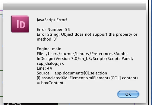

vze26m98
vze26m98Author
May 29, 2011
[The cleanup mentioned below, plus correcting an incorrect parameter value >blush< fixed my issue. Thanks again!]
Hi-
Thanks for your interest.
Re: the efficiency of iterations, I could possibly have a thousand, but I have to believe it will go faster than Applescript. The pointer to getElements() is very helpful.
As far as my main question goes, here's some cleaned up code. (Between a review of what I had and your suggestions, it's much simplified:)
function DATA(i, COL){
  return app.documents[0].selection.associatedXMLElement.xmlElements[COL].contents;
function setDATA(i, COL, boxContents){
  app.documents[0].selection.associatedXMLElement.xmlElements[COL].contents = boxContents;
When I run this, I'm able to READ the DATA through the first function, but WRITING the DATA through the second function gives me this:
So perhaps the typeof "contents" is an object and not a string, so ExtendScript does the conversion on read, but not on write?
Anyway, any insight is greatly appreciated!
Best, Charles
