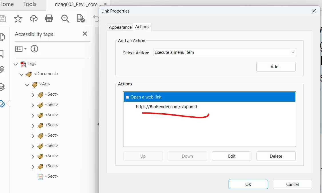

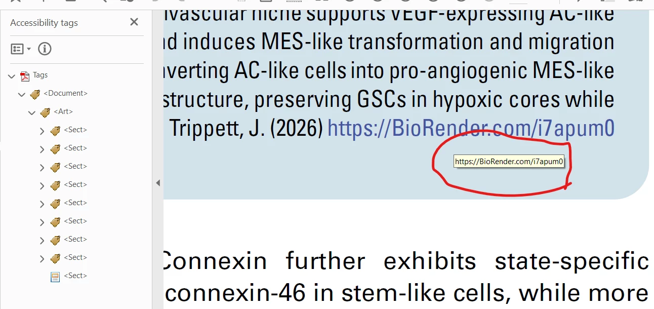

Screenshot 1: There were no [dot] in the hyperlink.
Screenshot 2: Checked link Property as well, there were no [dot]

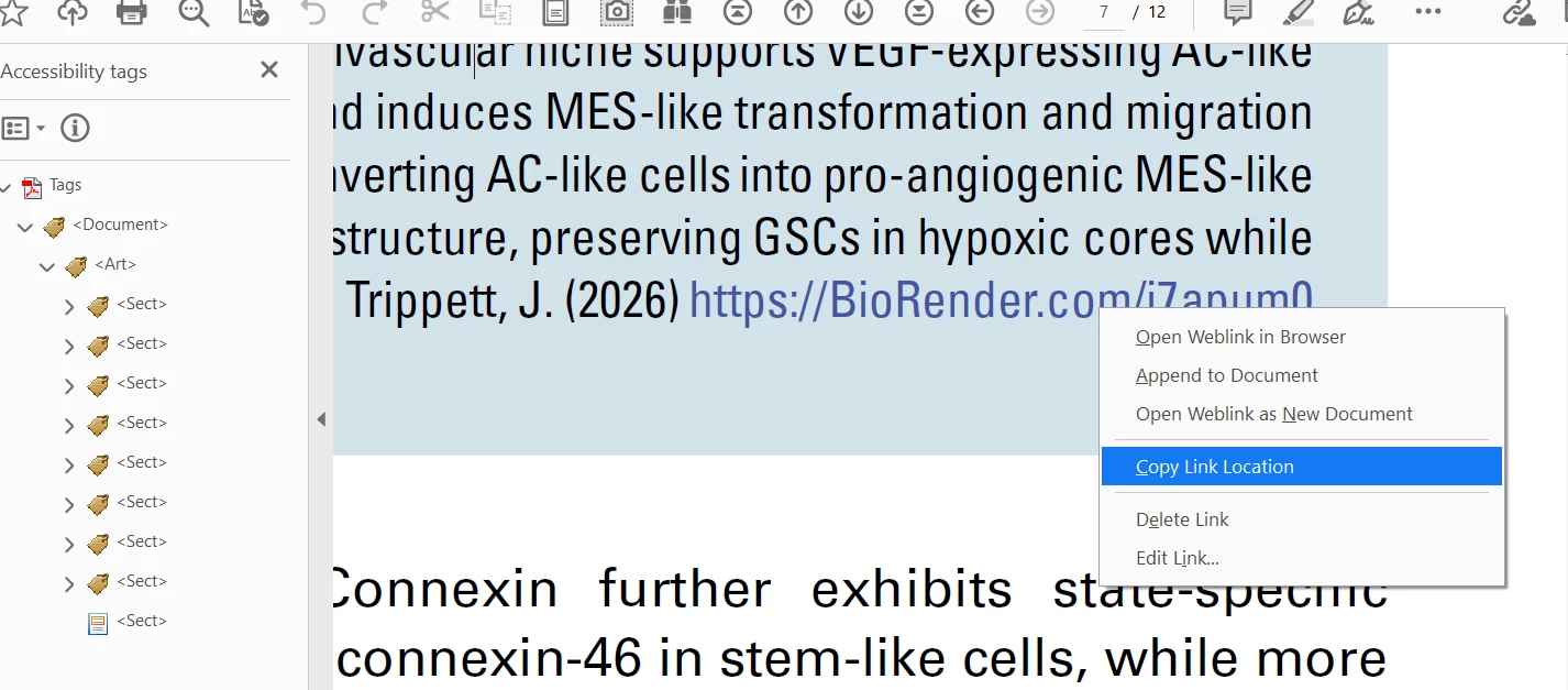

Screenshot 3: When I use copy link location, [dot] appearing.
