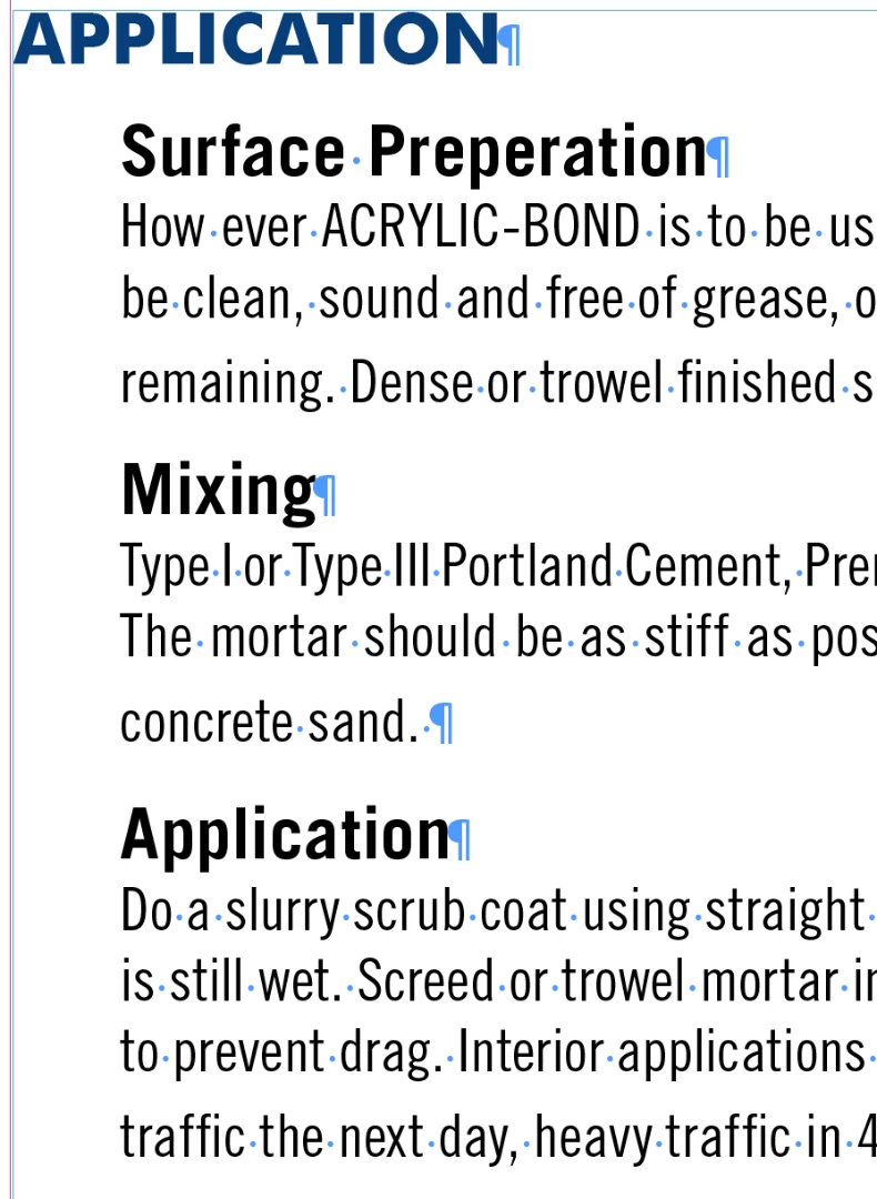

Extra Space Above the Last Line in a Paragraph?
Why would I be getting extra space above the last line in a paragraph? The problem isn't in the leading, space before or space after. Settings are the same for them through the whole paragraph, but the last line still gets set off a little too much. Is this a 2018 problem or am I missing something? Any suggestions for how to fix this?

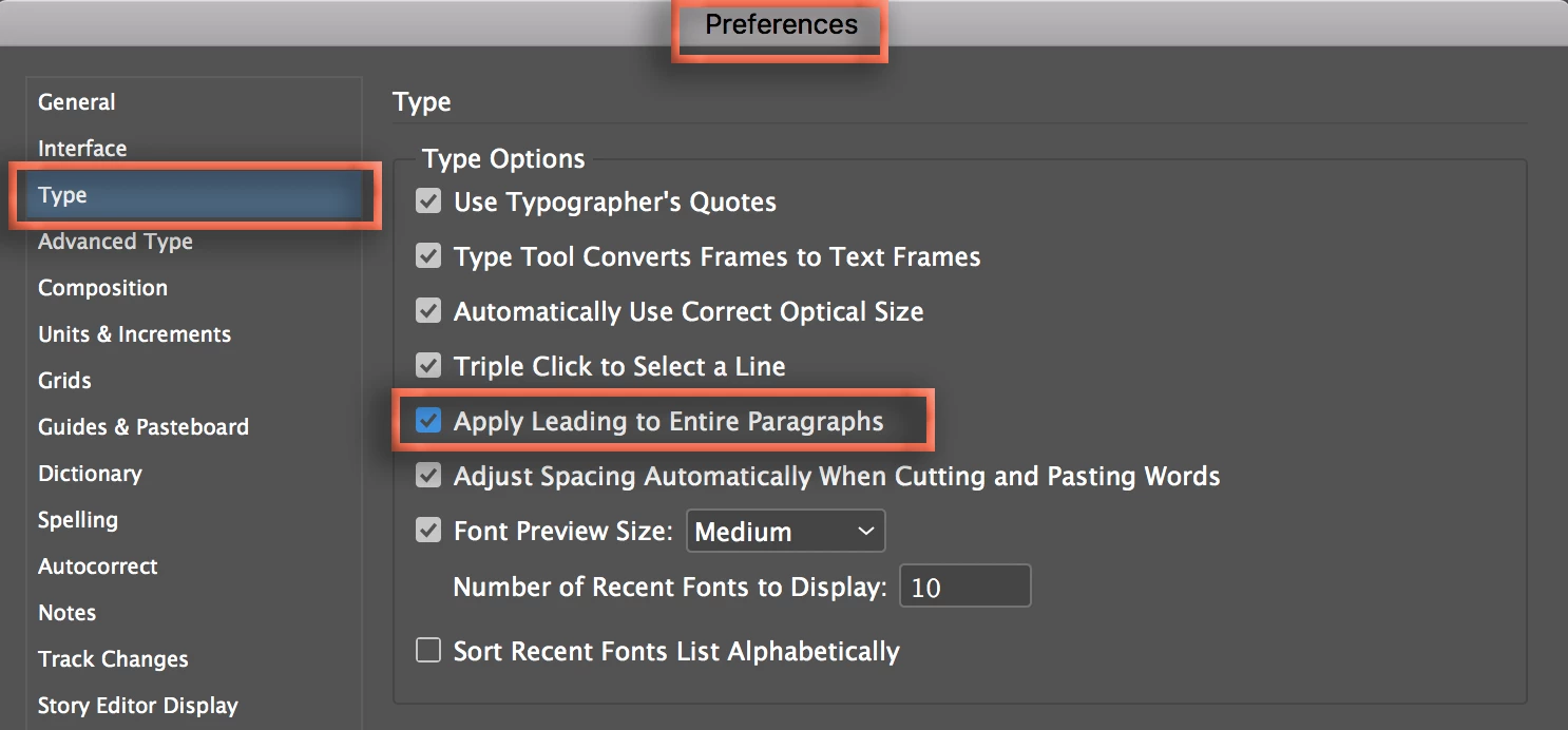

    Barb BinderCorrect answer
    Jan 7, 2018 12:20 AM UTC
    And to keep this from ever happening again, just enable Apply Leading to Entire Paragraph in Preferences > Type (off as a default).

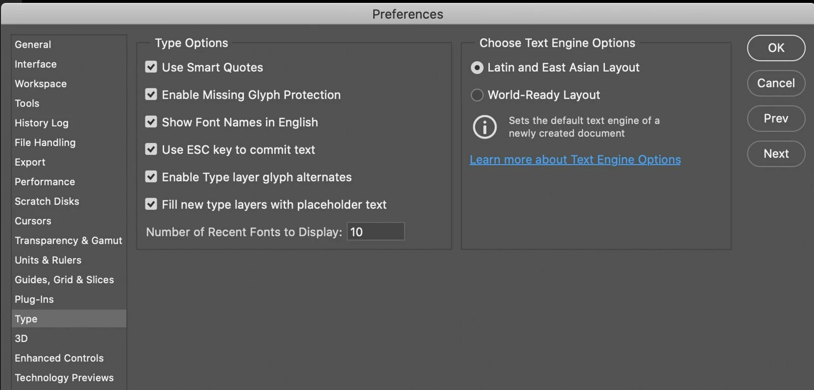

    Jun 9, 2020 4:04 PM UTC
    Looks like the location for those settings changed. Can't find them anymore.  
    Barb Binder
    Jun 9, 2020 4:12 PM UTC
    Ben,  you are sharing a screenshot of Photoshop preferences. Photoshop does not offer the same level of type controls as InDesign.
    ~Barb
    Jun 9, 2020 5:23 PM UTC
    My apologies, that clears up my confusion. I assumed all Adobe software would have this feature especially Photoshop. Thank you very much.

    Barb Binder
    Barb BinderCommunity ExpertCorrect answer
