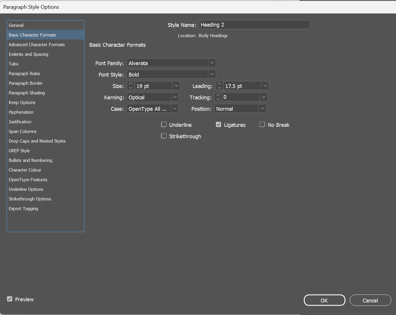

Here's a screenshot of the basic paragraph style options. The only unusual thing (as far as I can see) is using OpenType All Small Caps. In the advanced options, I'm not using any tracking, scaling, skewing, baseline shift, etc. (There's also no nested styles or GREP styles at work.)

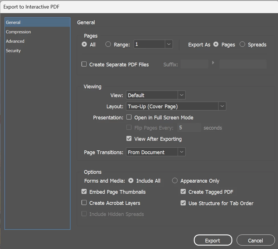

What settings did you use to export the PDF?
Mike Witherell
Nov 15, 2024 8:53 PM UTC
Hi Mike, I used these export settings. I also tried without Create Tagged PDF but it didn't change the result.
