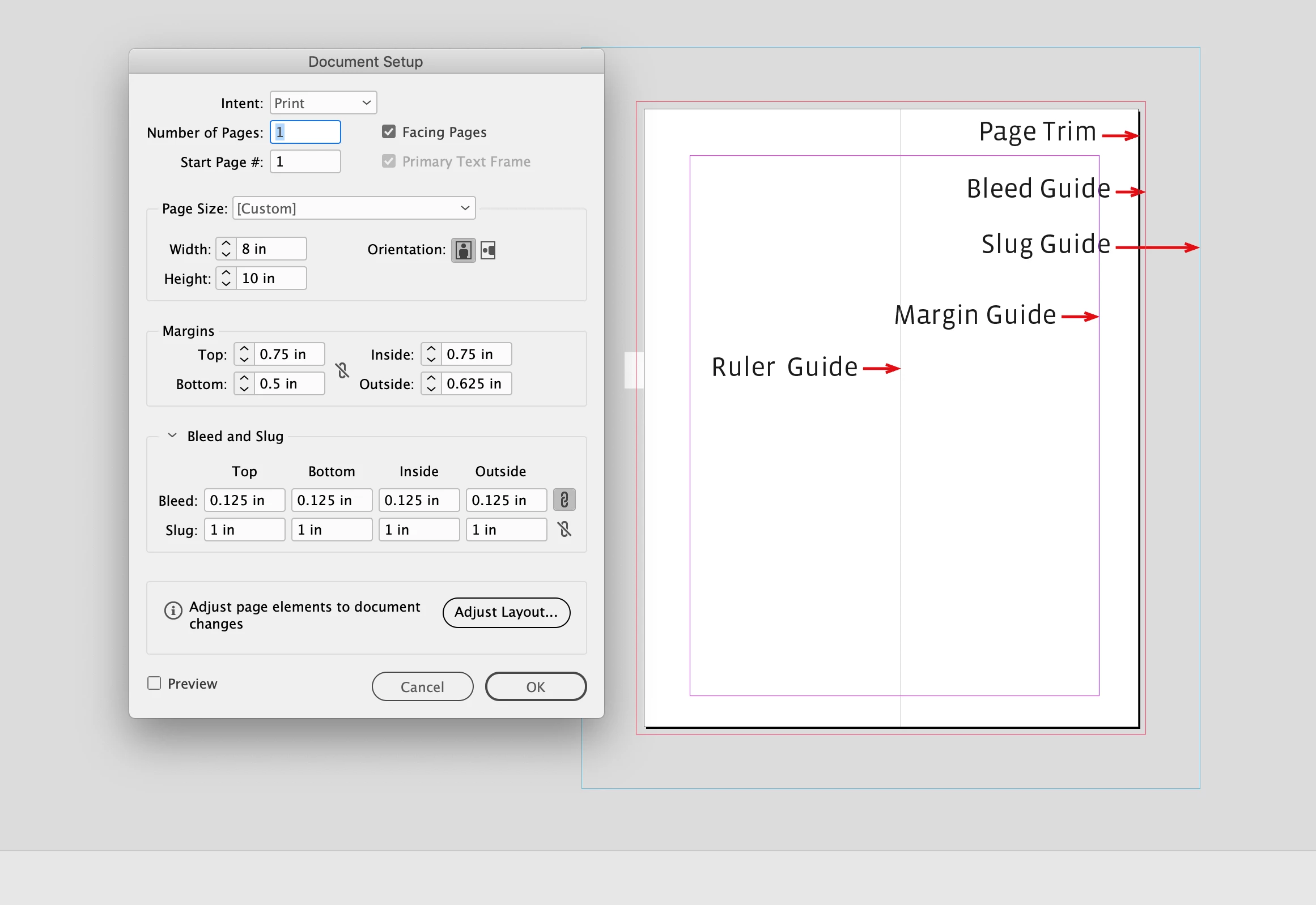

I seem to have a layout issue. I am desiging an 8" x 10" book for print, with facing pages layout.
I set the following specs in the Document Setup:
Facing pages with 2 columns
Margins:
Top: 0.75 inches
Bottom: 0.5"
Inside: 0.75"
Outside: 0.625"
Gutter: 0.375"
When I print out 2 facing pages onto 2 sheets of 8.5" x 11" paper, and rule them up to inspect the trimmed 8" x 10" published pages, the right page appears fine, with the 1/2" excess to the outer, right edge of the paper. However, the 1/2" excess that will be trimmed from the left page is to the inside margin, not the outside margin.
Is this an issue or not?
Should the excess be to the outer edge of both facing pages? Or should the excess be on the right side of both facing pages?
If this is an issue, how do I correct it?
