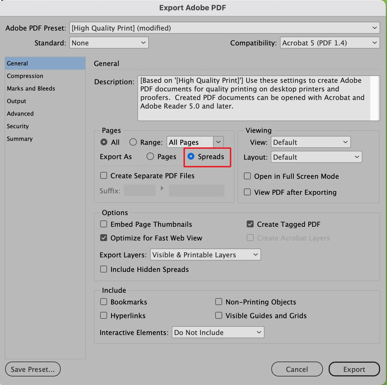

Facing Pages PDF not showing properly
I have created a facing pages documnet. (sample idml attached).
Bleeds are given 3.175mm all sides. Ideally inside bleed should be ignored by pdf and Indesign.
When I create pdf, in page 2 and 3, in fact, in all the pages, I see a bleed gap. Ideally it should show the output as it shows in Indesign alongwith the crop marks. What am I doing wrong?
Thanks
IDML and PDF attached.

Bill Silbert
Jul 31, 2024 9:43 AM UTC
When you export the PDF make sure that "Spreads" is checked in the General section of the Export Adobe PDf dialog that appears. Doing that will export the file as the spreads that you've set up in InDesign.
Bedazzled532
Jul 31, 2024 3:17 PM UTC
@Bill Silbert Thanks. It worked.
