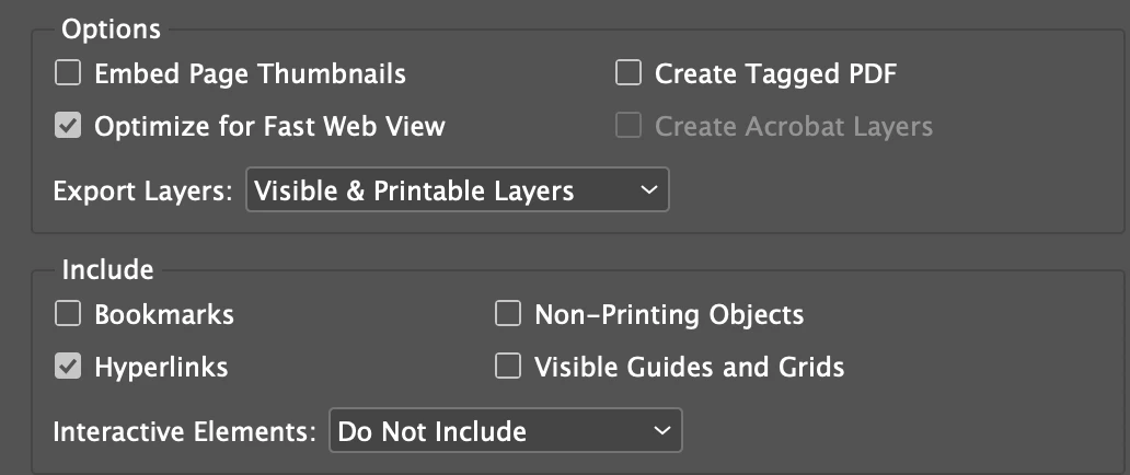

February 10, 2021
Was having the same issue with a 140-page catalog file. I just turned on the include Hyperlinks option during export and it worked fine. No other setting changes or workarounds needed.
