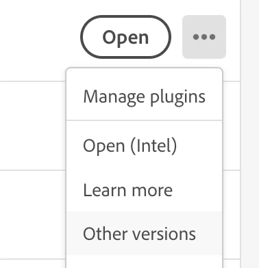

If you're running InDesign 18.5, then it appears that many users experience the same issue (judging by the amount of similar posts on the forum).
First, update to macOS 13.5. It solved the issue for some users.
If it doesn't help, then users recommend to install an earlier version - preferably 18.3. You can do it from the Creative Cloud app:
