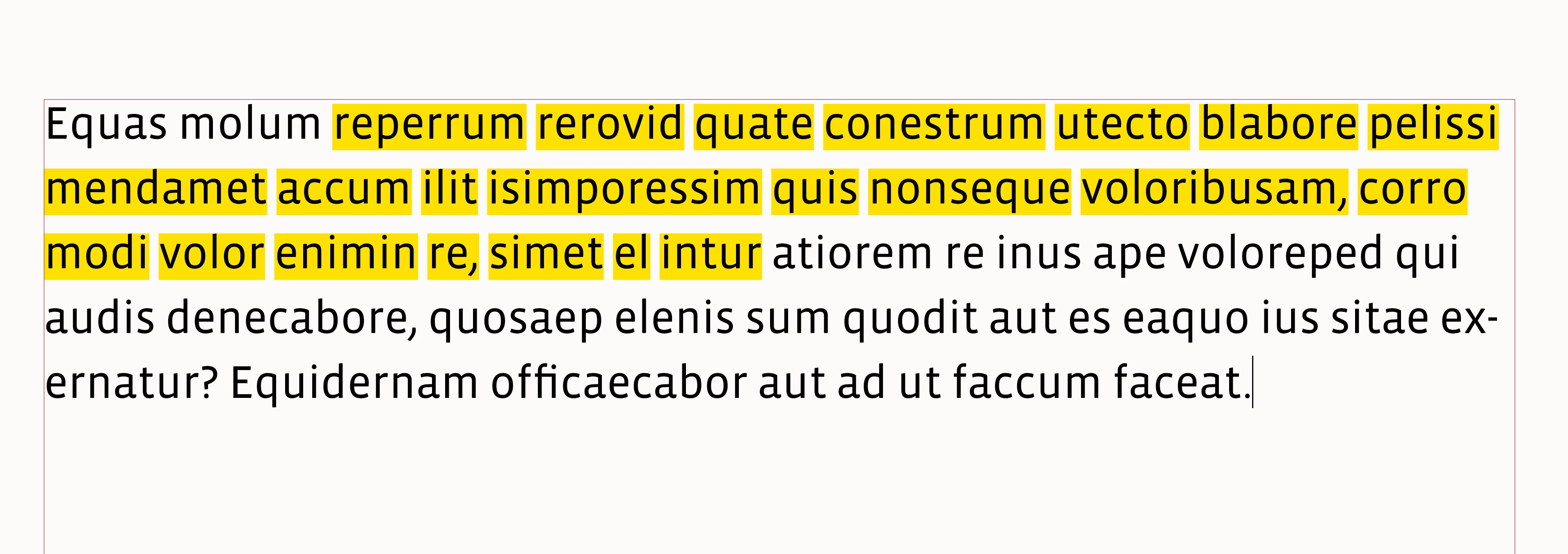

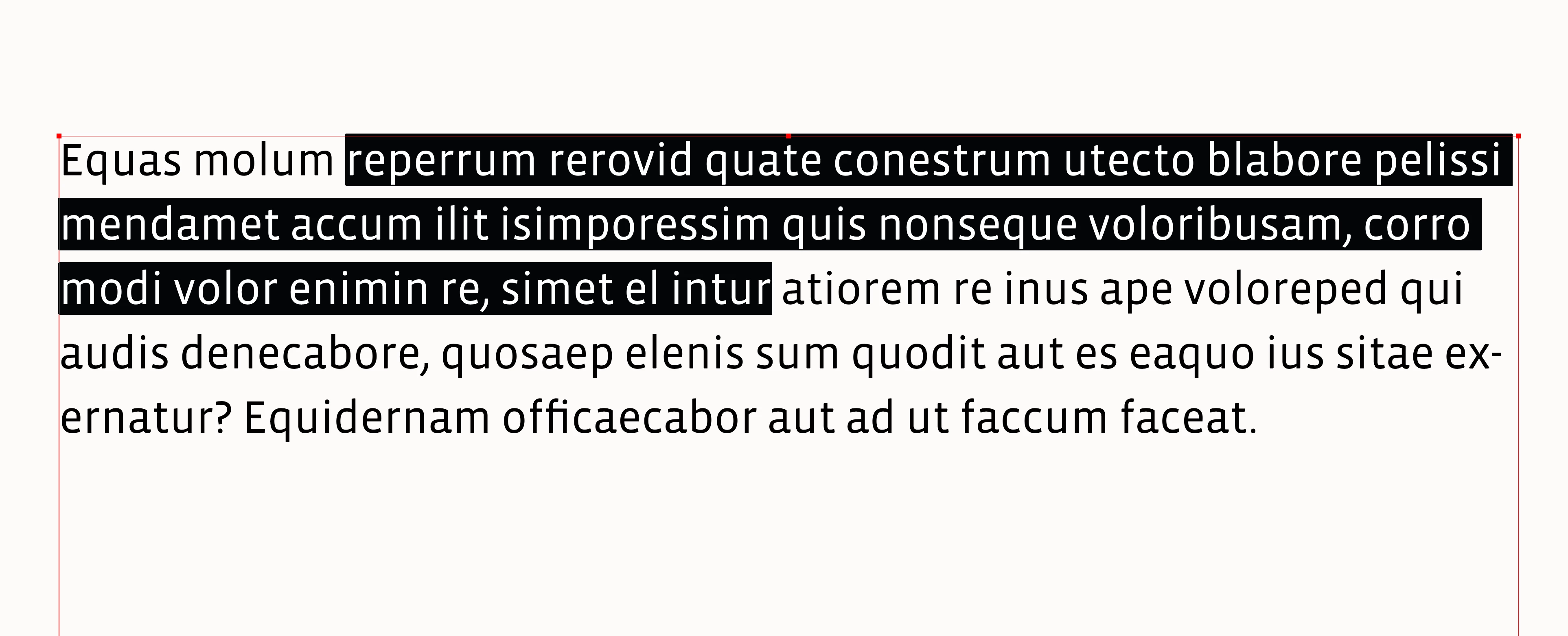

    rob day
    Oct 15, 2026 4:28 PM UTC
    Something like this where the selection is one or more words. Adds a new swatch named “Highlight”
    highlightWords(app.activeDocument.selection[0])
    * Adds an underline to highlight the words of a selection
    * @ param Selected text with at least 1 word
    * @ return value void
    function highlightWords(s){
    if (s == undefined) {
    alert("Please Make a Selection")
    return null
    if (s.constructor.name == "Text" || s.constructor.name == "Word") {
    var c = makeSwatch(app.activeDocument, "Highlight")
    c.properties = {model:ColorModel.PROCESS, space:ColorSpace.CMYK, colorValue:[0,5,100,0]}
    var p = s.words[0].pointSize
    s.words.everyItem().properties = {underline:true, underlineColor:c, underlineWeight:p, underlineOffset:-(p*.25)}
    * Makes a new named Swatch
    * @ param the document to add the color to
    * @ param color name
    * @ return the new swatch
    function makeSwatch(d, n){
    if (d.colors.itemByName(n).isValid) {
    return d.colors.itemByName(n);
    } else {
    return d.colors.add({name:n});
    Before and after
