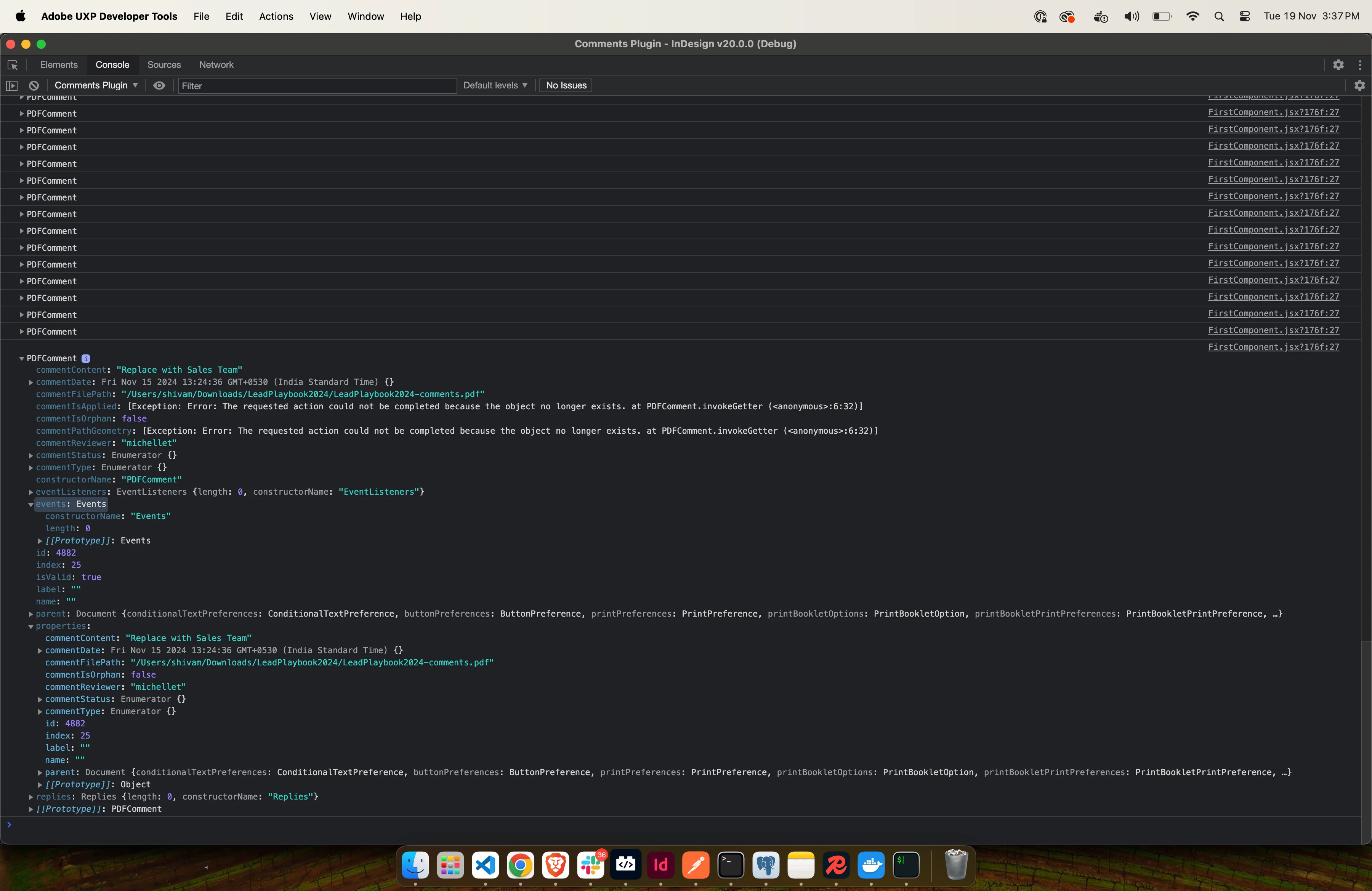

Fetch comments, geometry on which comment is applied, giving error [the object no longer exists]
I am using indesign version 20.0.0 ans UXP verison 8.0.1.
I want to fetch the location of comment in pdf where it is applied.
PdfComment's property commentPathGeometry is giving error.
Exception: Error: The requested action could not be completed because the object no longer exists. at PDFComment.invokeGetter (<anonymous>:6:32)
Below is the code snippet which I had used for fetching comments and screenshot of PDFComment object with exception..

Peter Kahrel
Nov 20, 2024 3:51 PM UTC
Strange that const works in your script, because it isn't a const. But anyway, UXP thinks it's not a problem (ExtendScript correctly returns an error here).
But your script works fine over here. Though when I try some other properties and run the script as a UXP one, I get the same error you saw. commentPathGeometry, for instance, throws that error. Both in 2024 and 2025 on Windows. Strange situation.
