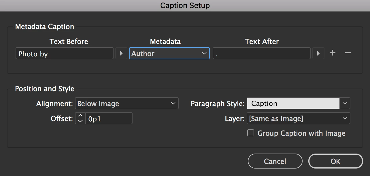

    Adding captions is a two-step process:
    1. Object > Captions > Caption Set-up is where you define how new captions should look in your document, including pulling in metadata from Bridge, where to place the caption and which paragraph style you want it to use.
    2. Once defined, select one or more images and choose Object > Caption > Live | Static Captions. Remember that live captions will update if you update the metadata but must fit on a single line, static captions can run across multiple lines but don't update after a metadata update.

    Thanks, Barb,
    This looks potential every useful. I’m 'almost home’: The first time that I tried to generate a live caption from metadata, nothing happened. On the second attempt, the ‘generate live caption' and other options were disabled (greyed out).
    Also, in the process of generating new captions for only two existing images and all thee 48 others already had sequential image numbers, now all of the old image numbers are gone. It is not the end of the world, b/c the document s not that long, , but it is an irritant to have to repeat all of that work. If I can somehow, easily, recover the image numbers, that would be extremely helpful. Or maybe I should just ‘bite the bullet’, and enter all captions into metadata.
    But. first I need success with the first couple of images, before going ahead and placing all captions into metadata, and go on from there, b/c I can see that a;; of this will be very helpful going forward

    Hi Jack;
    It can be tricky to figure out which metadata field you want. The names in InDesign don’t always match the names in Bridge, so that is one reason why the caption might be empty. Another might be that you’re referencing an empty metadata field. If it were me, I would focus on getting one single caption working correctly, then you’ll know how add all of the other captions.
    As for the figure numbers, be sure that you are tagging all the captions with a paragraph style and then add the figure number to the paragraph style. Again, see Steve’s post.
