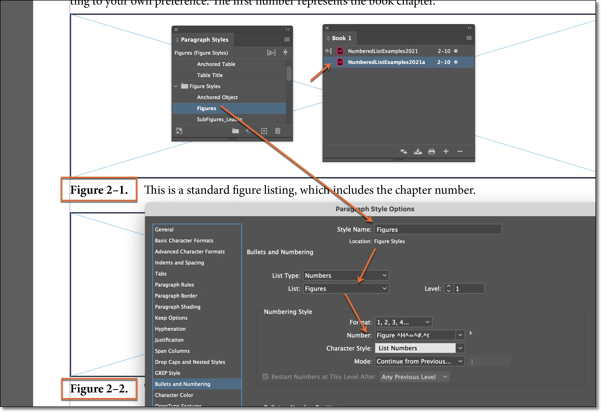

I have a long document with several chapters that contains graphics that need to be referenced. I need the caption to read somthing like this "Figure 2.1: Program Managment", where the first number is the chapter and the second number is the number for that graphic. I have a style setup for the caption that uses Numbers List Type. It worked fine when I inserted the caption on the first graphic, but on the second graphic, it did not update the number for the graphic. So instead of getting Figure 2.2 it shows Figure 2.1 again.
Below is a screen shot of my List Number settings. Can someone help me figure out what went wrong? I tried closing the document and opening it up again, but that didnt help.

Correct answer Dave Creamer of IDEAS
I've attached a file for you to look at the numbering code. One thing that will help is that each list should have its own List Type. Also, check your levels.

Mary:
I just realized that you added an attachment that shows how your numbers are set up. All of them are set up correctly in the attached .indd file.
Is this a template that you used as the basis for your document? The template has the numbers defined correctly, but they do not match what you shared with us as a screen shot. I saved the template file with a 2 at then end, put it in a book and updated the numbers. All numbers updated correctly.

Hi @maryr34816705:
You need to create paragraph styles, name your list and define levels. So far, this appears to be a two-level situation: chapter number and figure number. If there are more, you can let us know. We also need to know if your chapters are in one InDesign file or in multiple InDesign files, pulled together in an InDesign book file.
Are your chapter numbers incrementing as expected? Figure 1.x in chapter 1, Figure 2.x in chapter 2, etc? You didn't mention that as an issue so that should be ok. Check the chapter number settings: note the list name, make sure it is set to Level: 1 and note if you are using ^H or ^1 to increment.
Then return to the dialog box shown above. Use the same list name as above. Set the level to Level 2. The Number should either be:
Figure ^H.^2.^t
or
Figure ^1^2^t
depending how how you are incrementing the chapter numbers. ^H is used for chapter numbers in an InDesign book (.indb file), ^1 is used when the book is in single InDesign file (.indd file).
This post may also be helpful.
Dave Creamer of IDEASCommunity ExpertCorrect answer
September 7, 2021

Dave,
This file is very helpful and I think I've got it figured out now.
