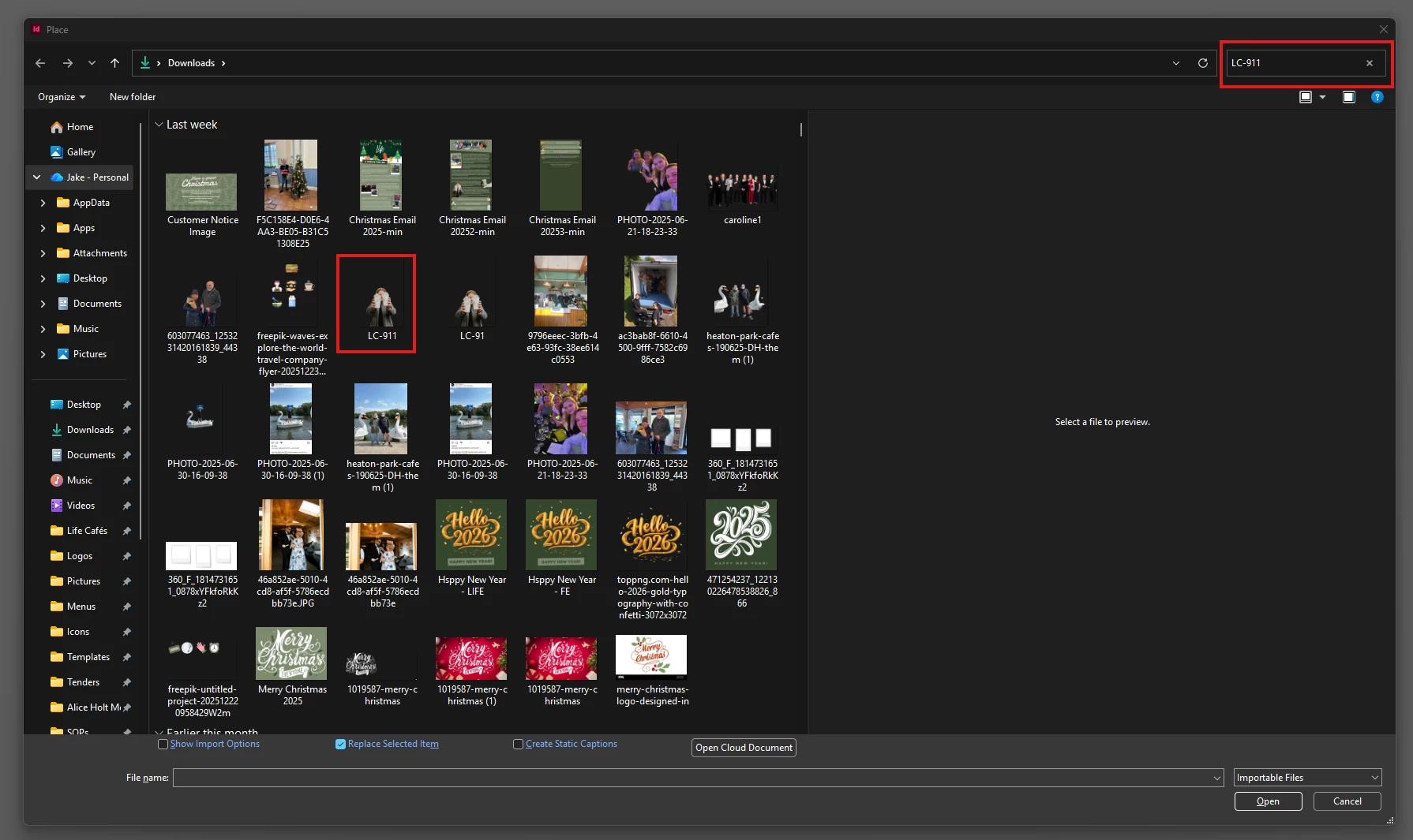

I'm having an issue with placing objects. When I press 'Cnrl+D' to place an object and use the search bar in the file explorer nothing happens and I can't file any files I'm looking for unless trawling through manually.
- I'm on windows
- It's not an issue of typos
- Searching for a file outside of InDesign works perfectly fine and locates files as it should
6 replies

Hi Abhishek,
I'm using Windows 11 and version 21.0.2 of InDesign.
This problem only occurs on InDesign (new and existing documents) and works
normally on Photoshop for example. I noticed that the problem began a
few months ago. I have since updated to a newer version to see if that
would fix the issue, and have also reset my preferences.
[image: Screenshot 2025-12-29 120620.png]
Kind regards,
*Jake Smith*

Hi Abhishek,
The screenshot dispays an example of an item I would like to search for, but isn't narrowing down search results or doing anything in fact.
