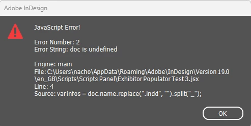

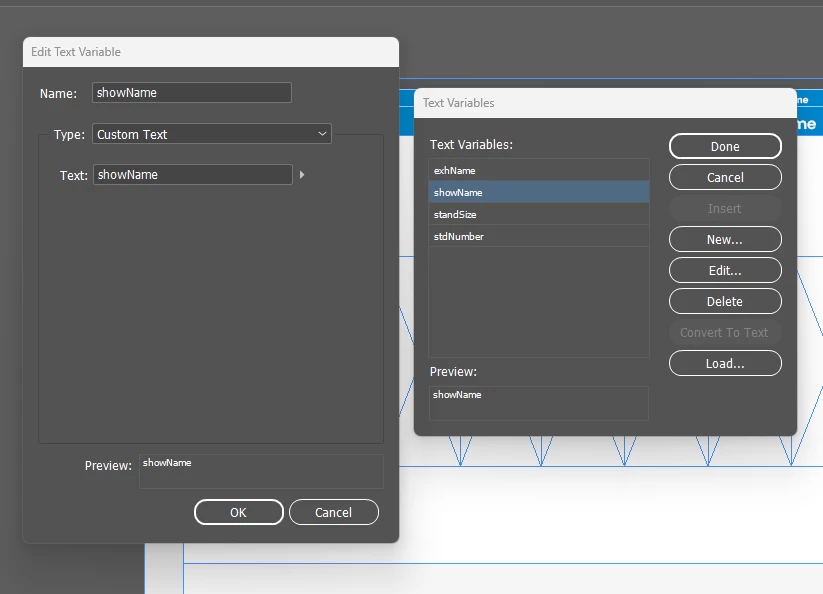

However, I have created Custom text as Variables for each (Show name, std number...) but I am getting an error on Line 4, see below:
Variables created as Custom text and applied accross the document:
Error from script:
Script used:

My apologies @IC2023, I picked some lines from the previous script but did not copy it fully. I have edited the code in my original post, please give it a try now.

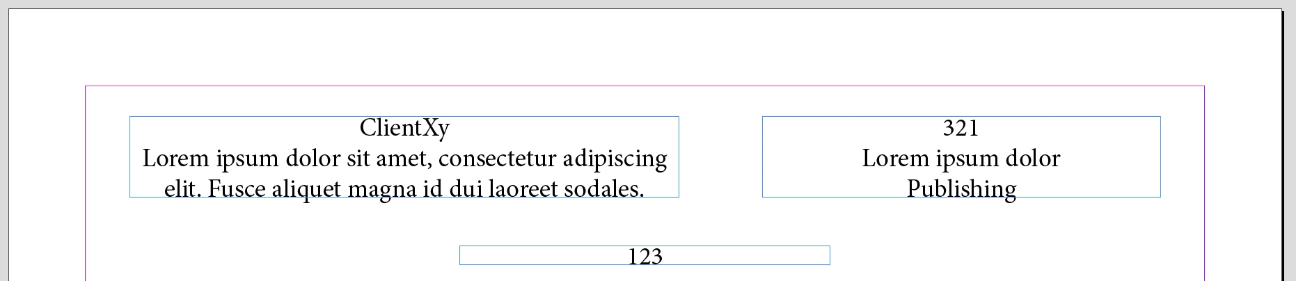

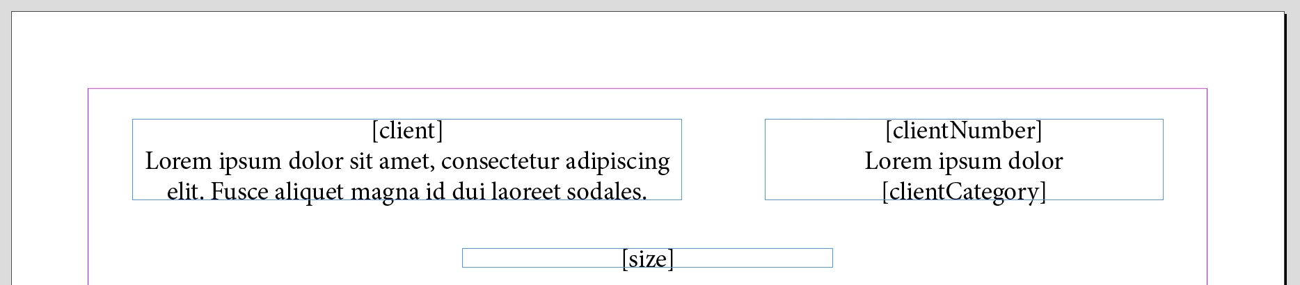

Instead of Info 1, Info 2 etc, I would put the wildcards in square brackets inside the template like this:
With the following code you achieve the described intention.
var infos = app.activeDocument.name.replace(".indd", "").split("_");
var varsToReplace = ["[client]", "[size]", "[clientNumber]", "[clientCategory]"];
var tfs = app.activeDocument.textFrames;
for(i=0; i<tfs.length; i++) {
	for(j=0; j<varsToReplace.length; j++) {
		if(tfs[i].contents.indexOf(varsToReplace[j]) > -1){
			tfs[i].contents = tfs[i].contents.replace(varsToReplace[j], infos[j]);
 Running the script inside the above file with the name ClientXy_123_321_Publishing.indd, the result looks like this:
