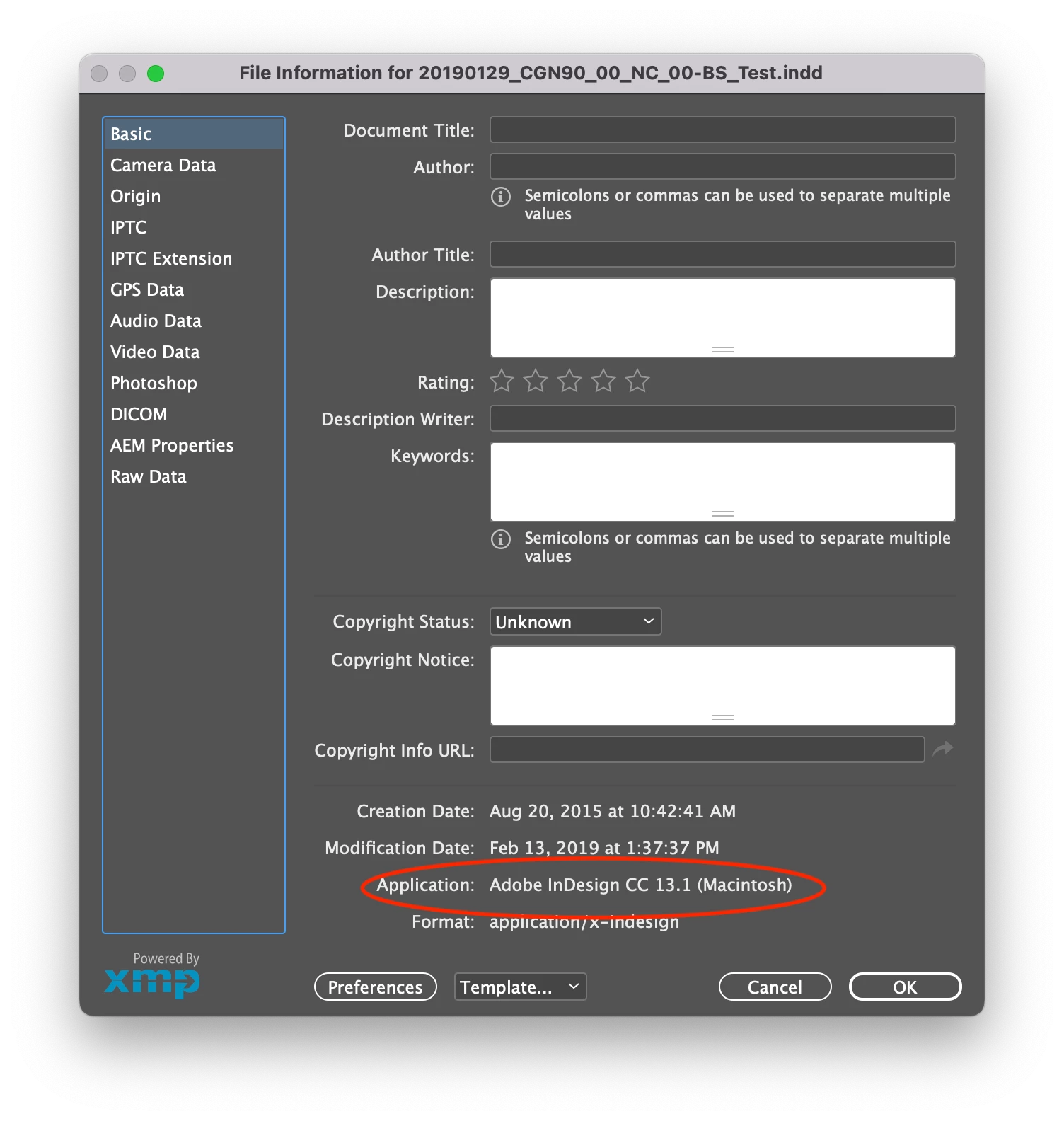

October 24, 2022
Hello @Gretchen G,
That behaviour is to be expected if the file(s) were saved in a earlier version of InDesign from the version you're now opening the file(s) in.
You can verify this by going to File menu > File Info.. > Basic and look at Application: to see what version it was last saved in.
Mike
