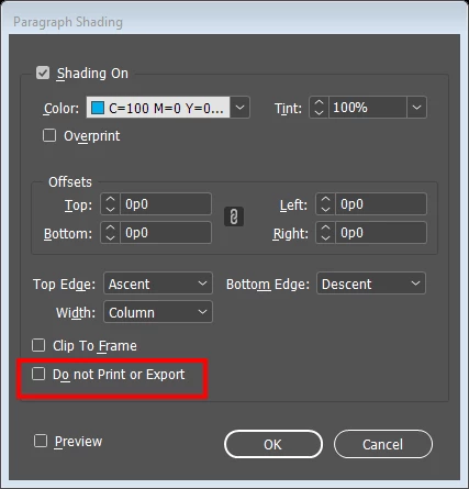

Did you check paragraph shading option in InDesign? It allows you to shade the text or the text in entire frame and that shading can be set to non printable.
Select the text you want the shading behind, and then enable the shading. Alt-click the below shown option to bring up the paragraph shading dialog box
You can then enable the below shown option to make the shading non-printable
You can then get something like
where the yellow color can be set to "Do not print or export"
-Aman
