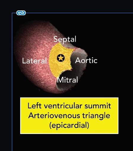

Incorrect 1: The star symbol is blurry and the star itself is essentially gone.

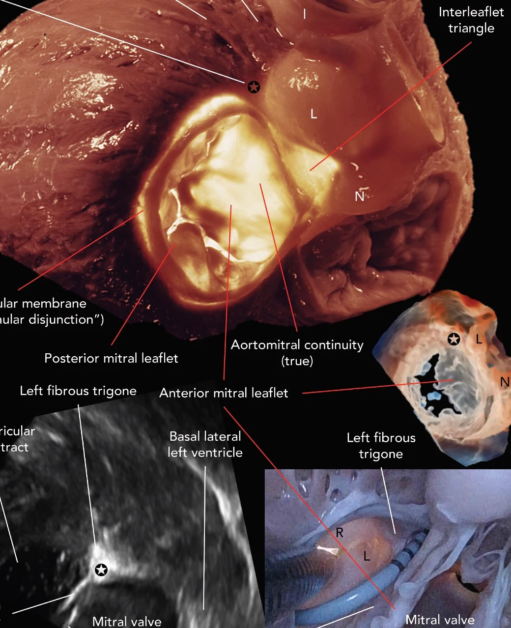

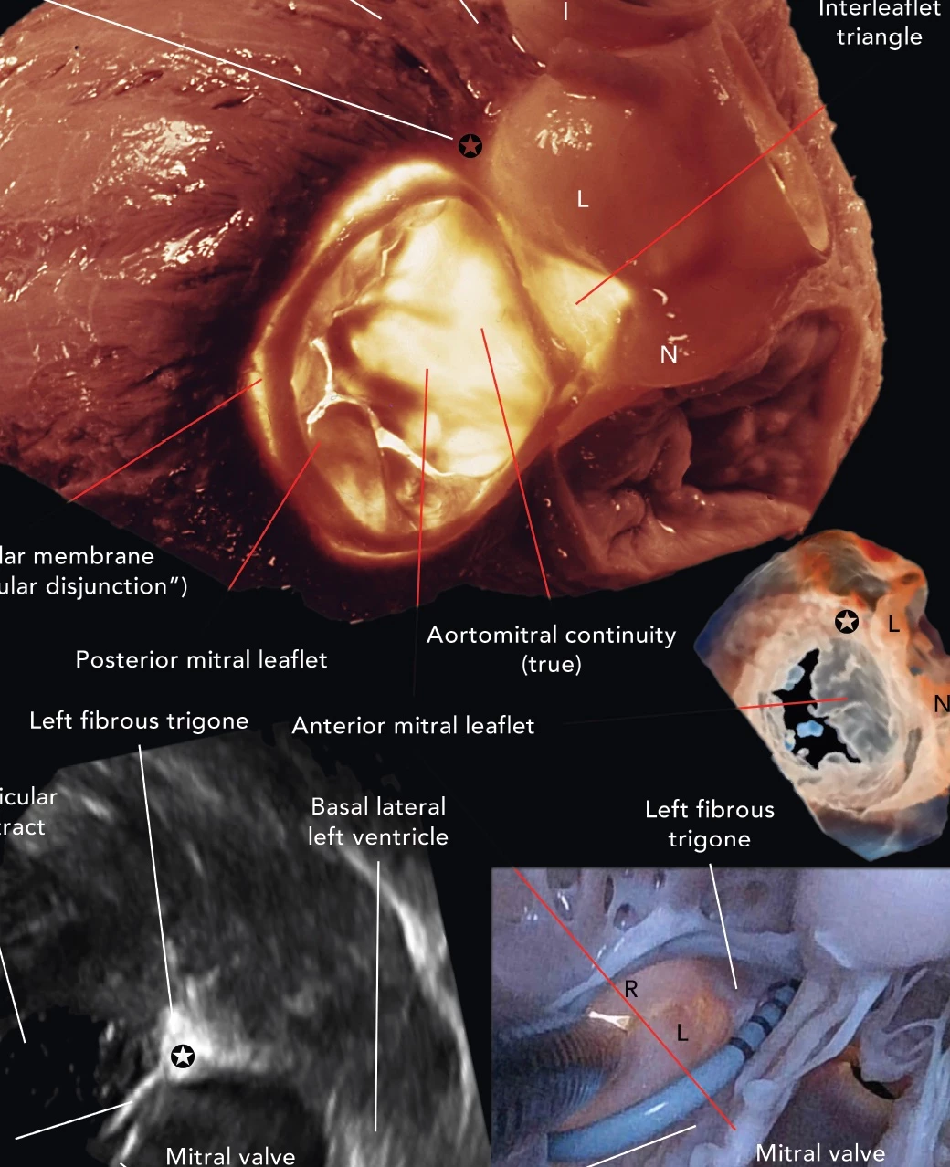

Incorrect 2: The red lines disappear almost completely when they cross from being on top of an image to being on top of the background.

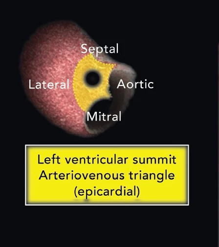

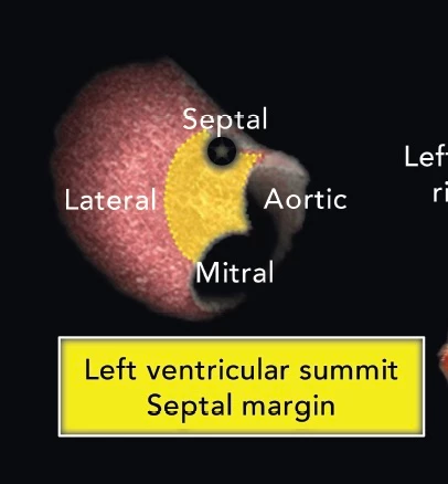

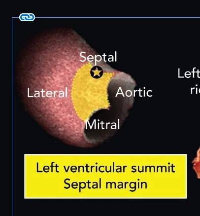

Incorrect 3: The star symbol is blurry, the star itself is gone, the yellow text box picked up a border, and the descender in the bottom line of text has blurred into that border.
