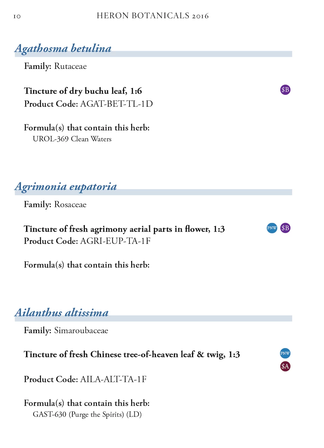

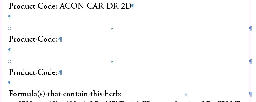

I have a long catalog document that I've done a complicated data merge with. I have some blank entries that I'd like to find and replace to get rid of quickly. However, I'm finding that I can't figure out how to use find and replace to get rid of these items. I'm trying to get rid of the empty Product Code lines in the attached image. I've tried a bunch of things, but can't seem to get Indesign to recognise anything but "product code" which isn't helpful. In the image I sent, it looks like I could type, "Product Code: (end of paragraph symbol), (standard carraige return), (tab), (end of paragraph), Product Code:, (end of paragraph), (end of paragraph)." I don't remember what the little codes are that indesign uses for these. I've just been selecting these options in the "@" drop-down menu. I've tried various combinations of these, but nothing works. Maybe I just don't know what these symbols mean? Help? 🥺

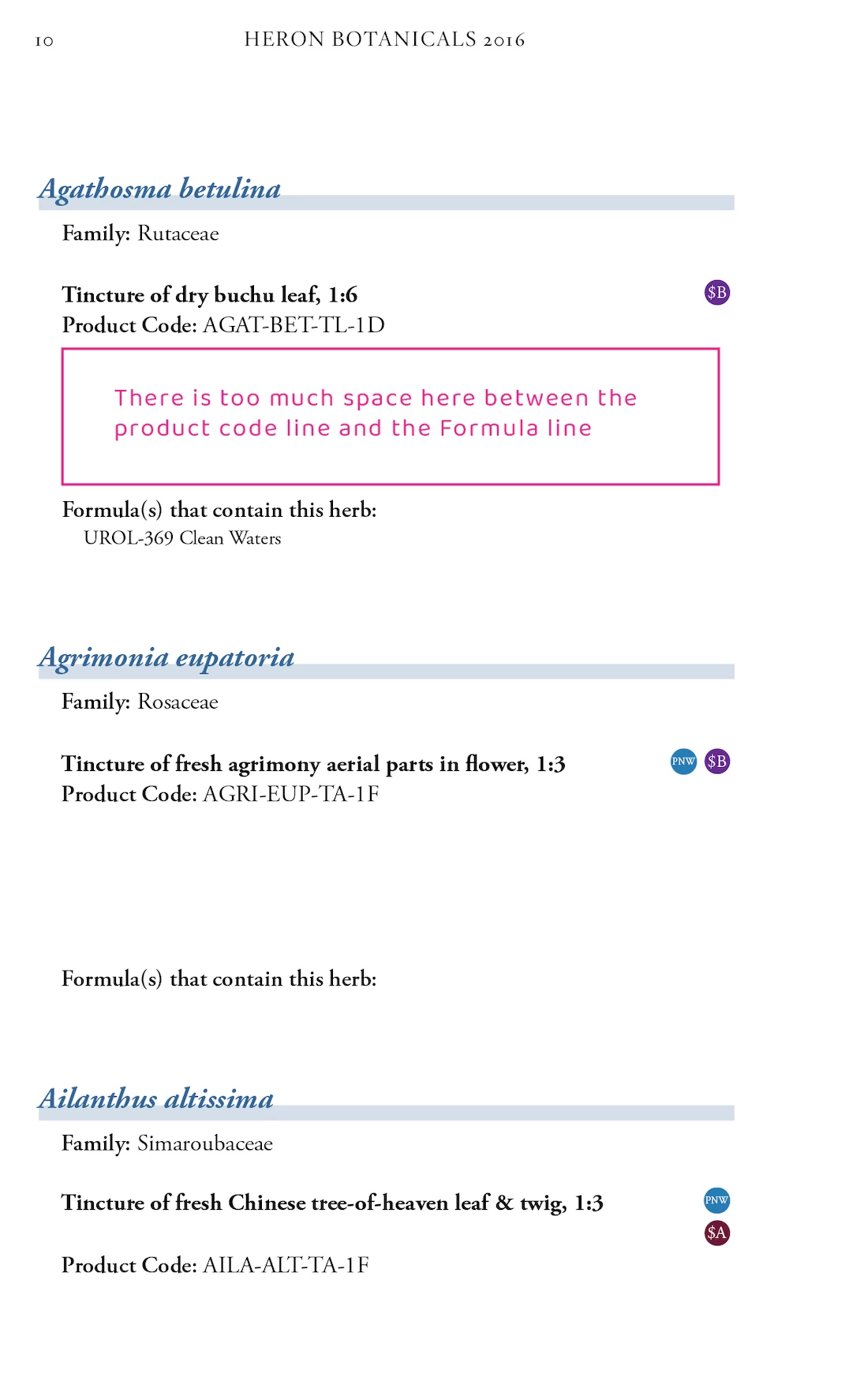

Hey, that's a good idea, @pixxxelschubser! I created a 2-page version packaged file, so you can mess with it yourself.
Here's again an example of what I don't want:
And an example of how I want the file to look in the end:
And to respond to you comment about avoiding unnecessary lines.... The reasons some of these empty product code lines are in there is because some of the herbs have 3 products, so there are 3 columns in my spreadsheet to account for this. But some have 1 or 2 products, which leaves empty product lines in some of the herbs listed. I couldn't figure out any other way to enter the data other than this way...
@Laubender - I tried the 2 codes that you sent and they did find matches in the file, but they only matched to 1 line of emptiness. What I need is to replace all 5 lines at once with 1 blank line. I'm sorry, but I don't have the words to correctly express myself. I'm not sure how to name a blank line... I tried adding your codes twice in a row, but that didn't find a match. The characters that are making up those 5 lines of blank space are complex and I can't figure out what they are made up of... Going through and manually deleting all of them will take a really long time 😞

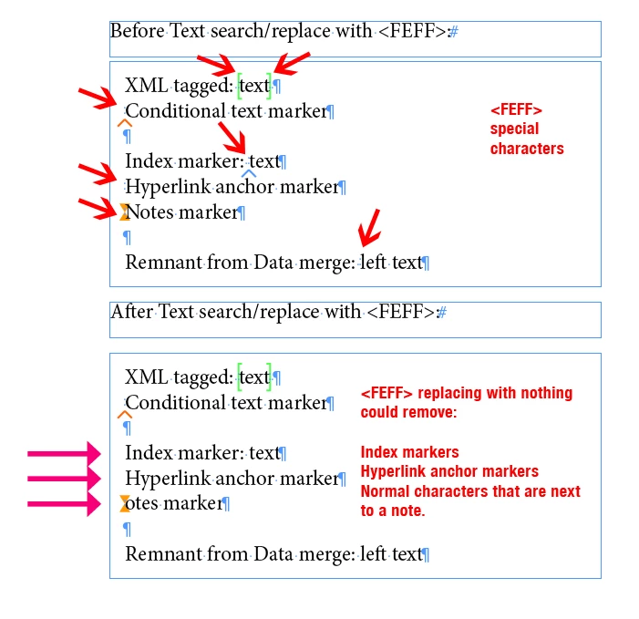

@pixxxelschubser is right! You are looking for <FEFF> special characters.
GREP will not see them. Remove them using TEXT Find/Change. But be aware, that <FEFF> special characters have various purposes. To remove them can be tricky. See this:

Ok, I managed to get rid of the empty product code lines with lots of trial and error and frustration... But now I'm left with a bunch of empty lines that I can't get rid of easily.
They look like paragraph symbols, so I've tried using 'end of paragraph' or 'standard carraige return' but I can't get anything to work... I just want to get these 5 empty lines condensed down into one empty line. Does that make sense? It seems this shouldn't be so hard...

IMHO, the two blue "colons" can be found neither with Grep nor with Script. They can only be found with the text search.
<FEFF><FEFF>
July 2, 2022
Hi @sarahpeller,
Try the following
Find What:
(Product Code:.*\r)(\h|\x{2063}|\r)*
Change To: $1
P.S.:- I assumed that the unicode for the special space character in your 3rd line is 2063 if it is a different character, replace the required unicode in the grep.
