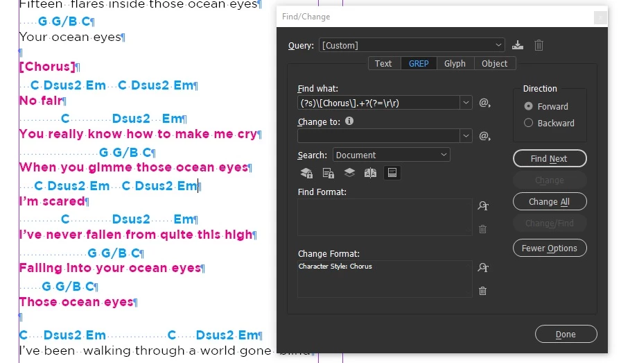

Hello, use to to apply your special style for the Chorus...
(?s)\[Chorus\].+?(?=\r\r)

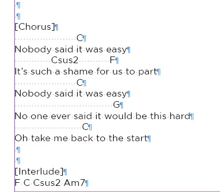

Unfortunately that didn't work. It does select the 7-8 choruses I mentioned that got selected with the code I mentioned in the original post:
But this chorus was not selected:
I wonder if I'm missing something very obvious.

jctremblayCommunity ExpertCorrect answer
June 30, 2021
You have spaces before the single return.
Either fix this before using the code I gave you or you can try with this new one:
(?s)\[Chorus\].+?(?=\r(\h?\r)+)
