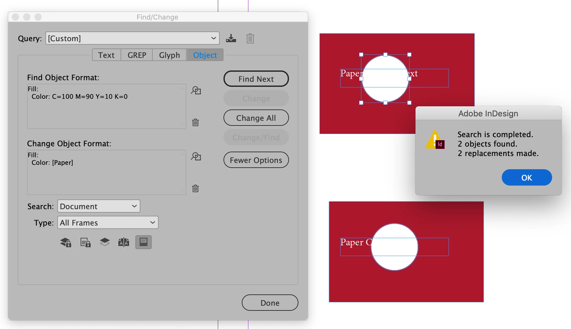

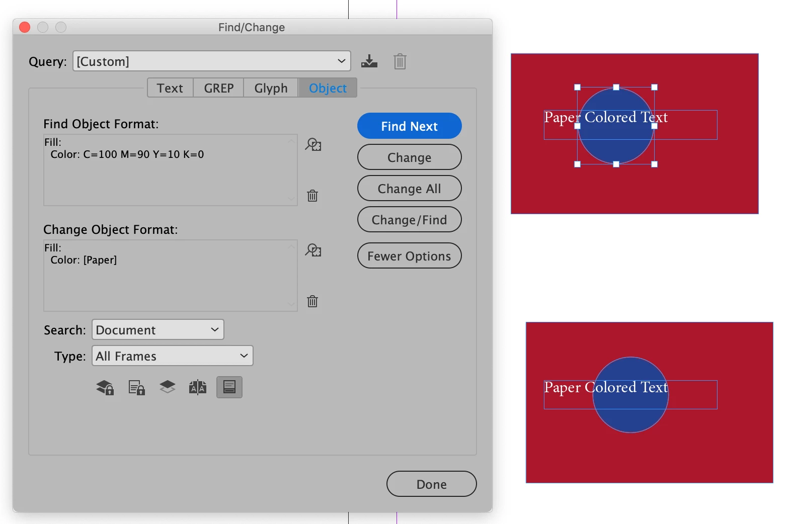

    I made a test with two copies: On each copy, the stacking order is:
         (top) Paper-colored text
         (middle) Blue filled circle
         (bottom) Red filled rectangle
    The only difference was that in the first (upper) copy, the circle and rectangle were grouped, and in the second (lower0 copy, they are not.
    Using the same search you used, grouping made no difference. Are you sure there is no other difference between those found and those which were not?

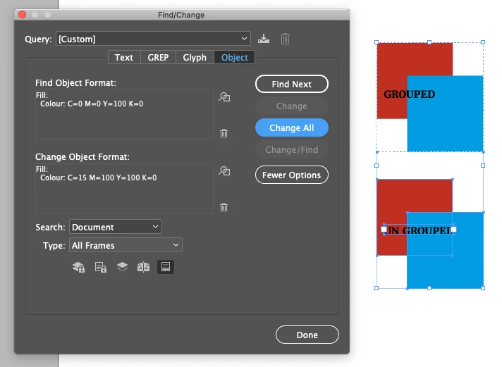

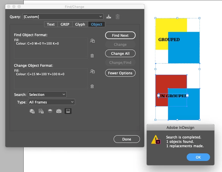

    Well, this is interesting.
    I wonder if I have found a bug...
    I want to change the Yellow to Red:
    1. It works if you select Search | Document. I can't use that as it would change other 'yellows' in the document that I don't want to change.
    2. It doesn't work if you select Search | Selection
    Can you guys reproduce this?
    Michael Bullo
    July 7, 2019
    I just ran some tests and I'm getting the same as you. When "Selection" is chosen, an item within a group that is expected to be selected is not. Interesting.

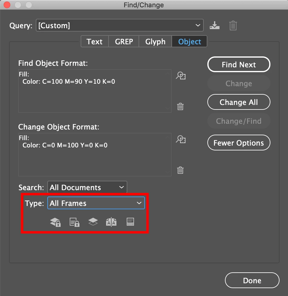

    July 6, 2019
    At the bottom of the Find/Change dialog box is a dropdown menu for Type and a series of buttons. Have you tried these?
