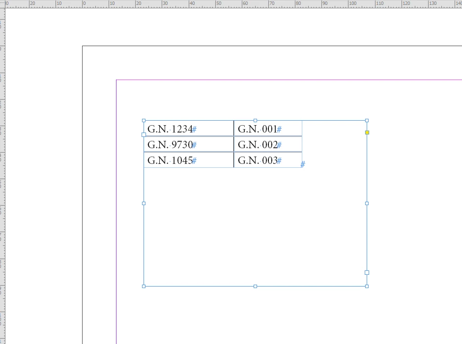

Hi hypons111,
so in effect are you saying that there is no logical way to compute the new number from the old contents?
Now that brings us to a totally different solution where you need to use a list.
How could that work?
You could do a table in InDesign, a second document behind the one you want to change the contents.
A table with two columns. Column one entries are the old number expressions, column two entries are the new number expressions just like that:
Next step woul be:
Make the other document the active one.
Have no other documents open, just the two.
Then run this ExtendScript script snippet.
It will pull the data from the document's table that is not the active document.
Column 1 contains the old text, column 2 contains the new text.
The script will then run on the active document with a loop and does find/change text actions according to the contents of the table in the other document:

Hypons111
Hypons111Author
November 8, 2019
no, cant use this skill on this job.  but Ajabon gave me a solution, im going try this at work tonight. thanks for helping ~
