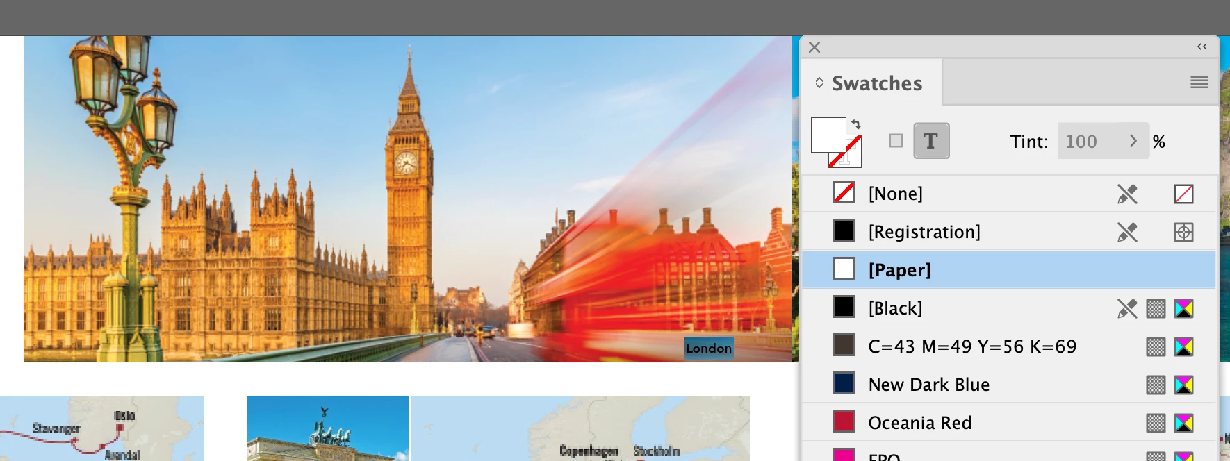

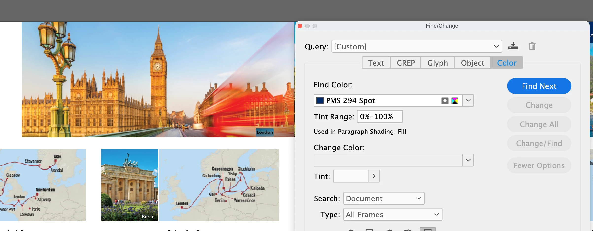

Thanks, The color on this caption is Paper. However when I search for PMS 294 it shows me the captions that I have in reverse,  as PMS 294. See
Robert at ID-Tasker
August 7, 2023
But the message is pretty clear...
Used in Paragraph Shading: Fill.
