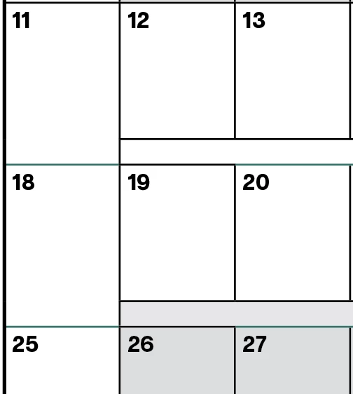

I'm using InDesign to create a document consisting of mostly tables for a calendar. When finished I create two versions, one spot colour document, and another fully black document. To do this I use Find/Change ->  Color to find my spot colour and replace it with black. It mostly works, but it fails to find lots of strokes. I'm using Table Styles, Cell Styles, Paragraph Styles for almost eveything. Why is it that Find can't find colours that I can clearly see on strokes?
Not sure if it's related, but it always seems to be on spanned cells or custom stroked cells. Any clues? I've attached a sanitised version of my tables (private info removed).

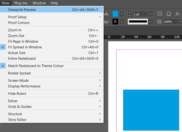

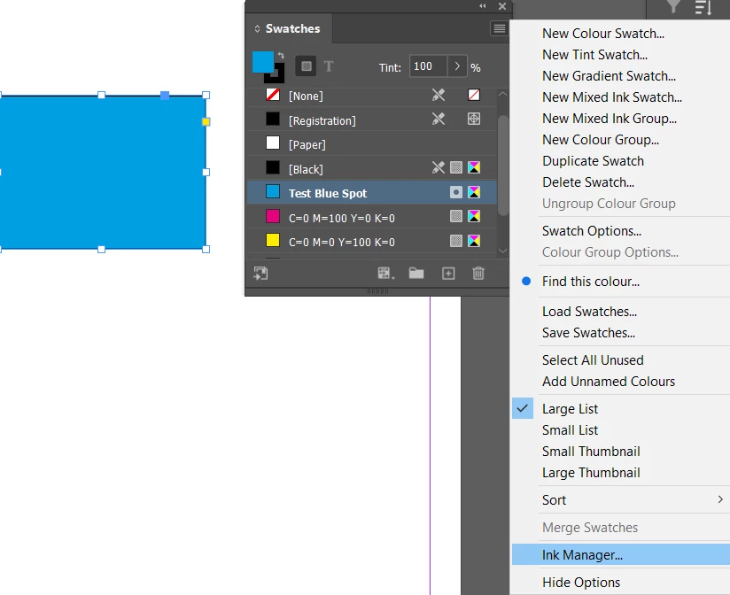

Ink Manager
Alternatively - if you don't want to delete the Spot colour - and retain it for the future

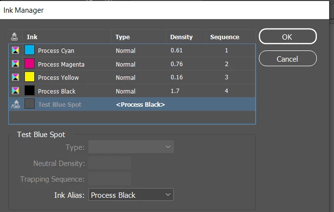

You can use the Ink Manager (found in the Swatches panel) and you can MAP the spot colour to black

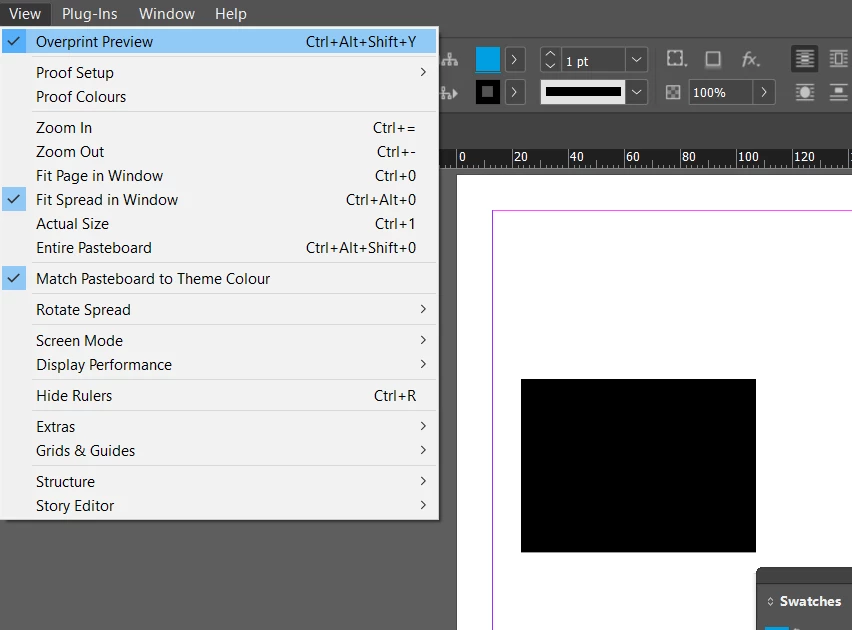

This would MAP all the spot colour to black ink - including in placed files, graphics, logos, files et.c where that spot colour is used are MAPPED to black colour.
However, caveats everywhere, if you do this your spot colour might be set to knockout, and for black you might to overprint the black instead of knockout.
For your sample - I don't think it's an issue
Then you can toggle between your spot colour view and the black view.
