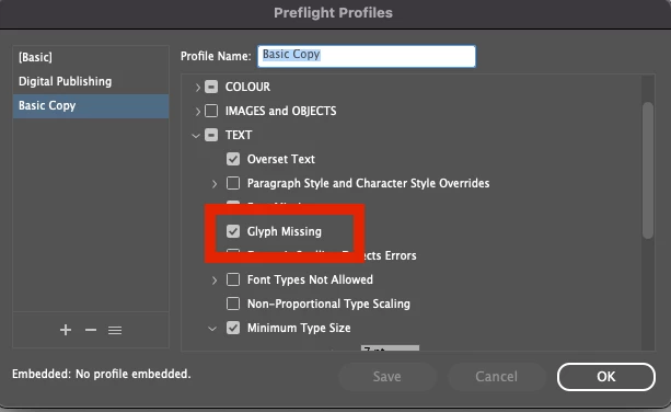

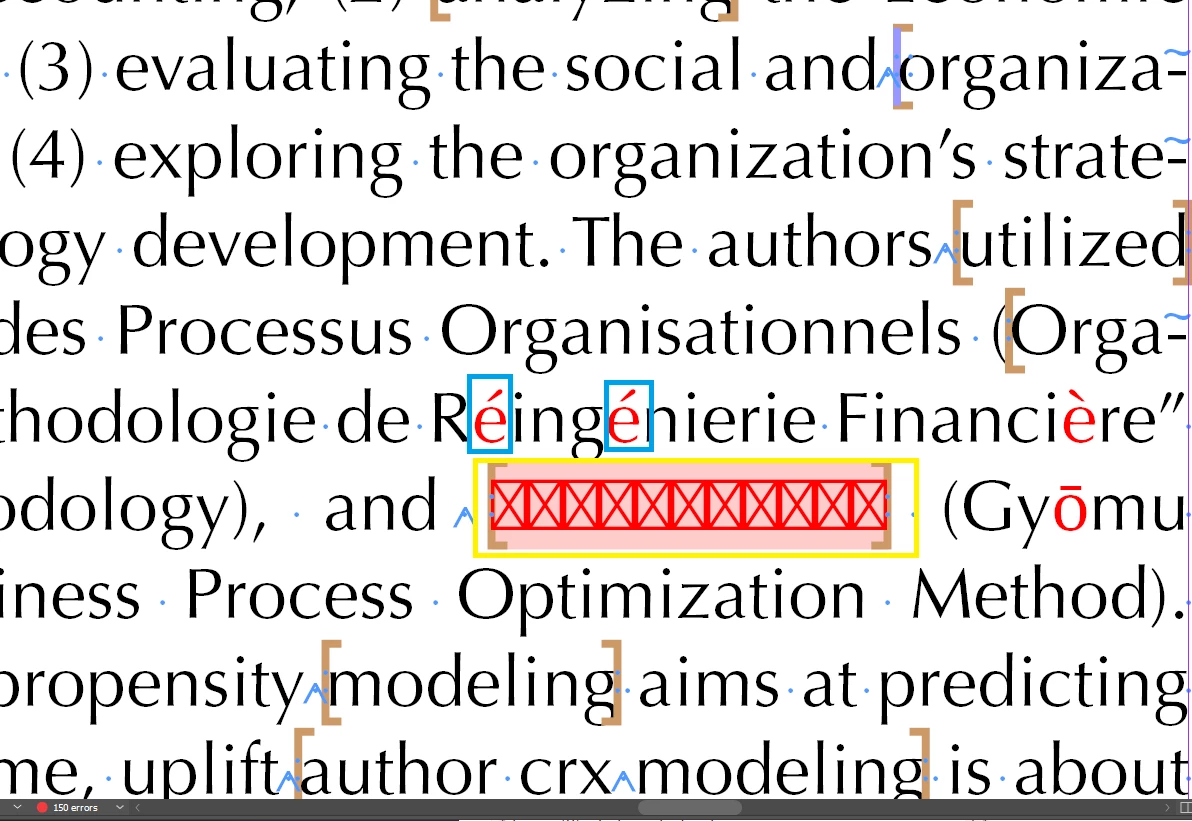

    The red “tofu” box you’re seeing isn’t actually a specific character you can target with GREP it’s a missing glyph (the font can’t display that character).
    That’s why your GREP is catching lots of “junk” but not specifically those boxes. GREP works on the character itself, not how it renders.
    If you want to find those tofu boxes specifically, the most reliable way in InDesign is:
    Use Preflight > enable “Missing Glyphs”
    That will flag exactly those characters
    If you still want a GREP approach, the closest you can do is narrow things down with something like
    [^\x00-\x7F]
    but that will also catch valid characters like accents, dashes, etc., so it’s more of a broad sweep than a precise solution.
    If you need automation, a script is the only way to properly isolate missing glyphs, because it can check whether the font actually supports the character.
    So in short:
    GREP = good for general cleanup
    Preflight = best for tofu/missing glyphs
    Script = best if you want to automate it

    Divya DR
    Divya DRAuthor
    Apr 27, 2026 5:27 AM UTC
    It works, but my requirment is to take only the tofu square, but it  highlight all the junk char can you gimme to find these type of junk.
    Apr 25, 2026 3:02 PM UTC
    Depends what you want to do
    First thing I think of here is the Preflight - and to check for Missing Glyphs - that would pretty much do it.
    You mentioned scripting, but not what you’ve tried or what isn’t working or why it’s not working - or even what you want it to do.
