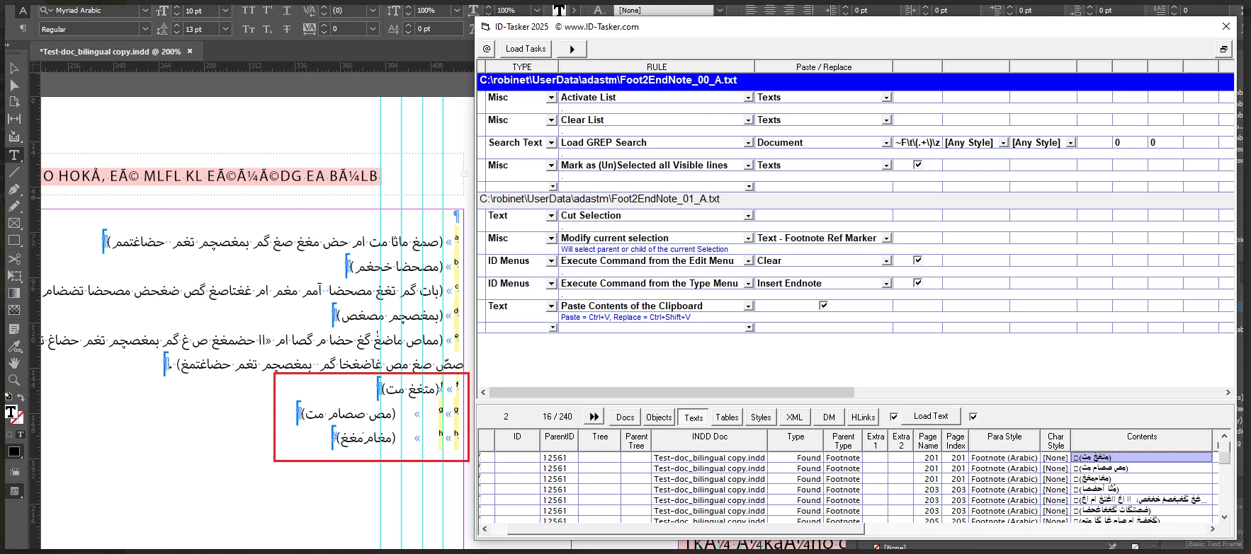

Dec 21, 2024 2:31 PM UTC
Here is the whole process - based on the file provided by A2D2 -- which shows, that ID-Tasker is perfectly fine with RTL texts as well.
THIS IS VERY IMPORTANT - Endnotes option NEEDS to be set to "On a New Page":
Otherwise, it will create bunch of separate TextFrames for each Endnote.

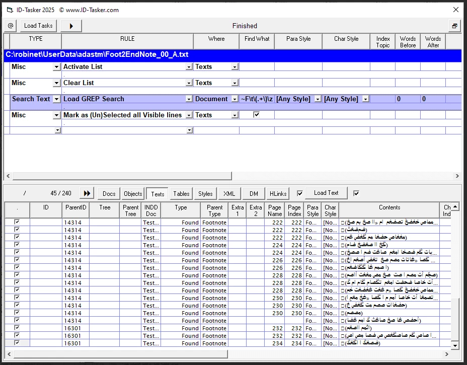

Let's load Footnotes in "( )":
As per screenshot - Arabic text is displayed in the IDT's UI as well.

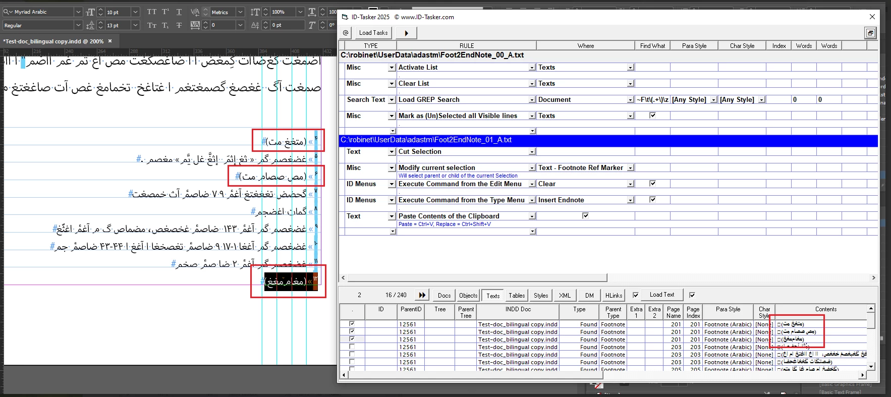

I want to convert only those 3x selected:

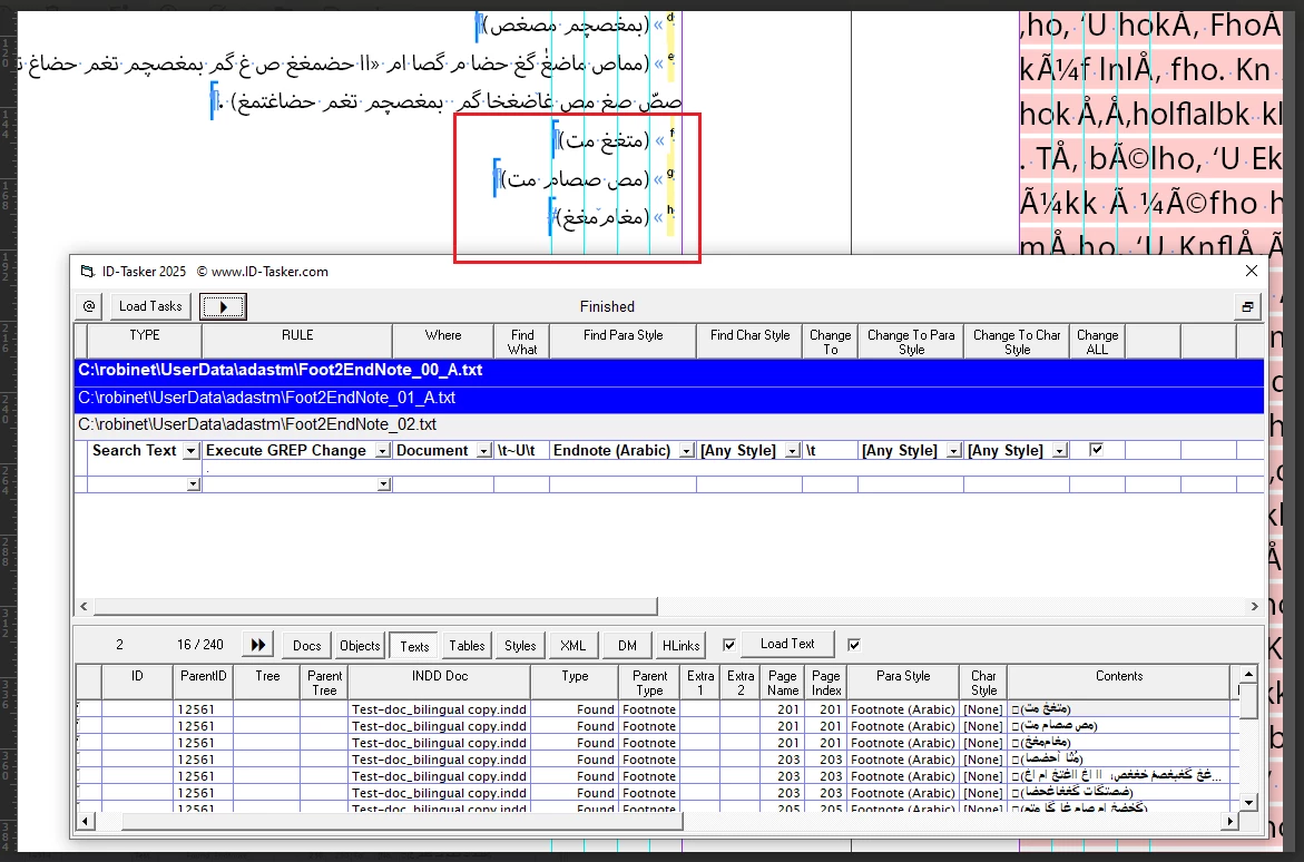

After conversion - references are doubled:
And fixed:
