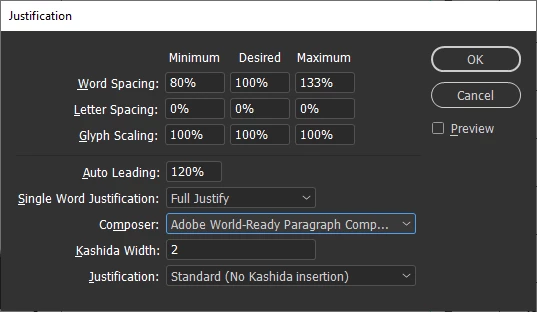

Can I ask you to post a sample? Have you tried it in another font? Usually, that kind of thing is handled within an OpenType font by "mark-to-mark positioning" which means that I suspect you won't be able to correct the rendering of niqqud by the order in which they were keyed. The positioning of such marks is usually part of the font. It is maybe manipulable from an OpenType menu, or perhaps the insertion of a few Unicode control characters can force it to render as you expect, but I personally wouldn't know until I tried.
Joel Cherney
March 18, 2022
Also can we assume that you've turned the World-Ready Composer on?
