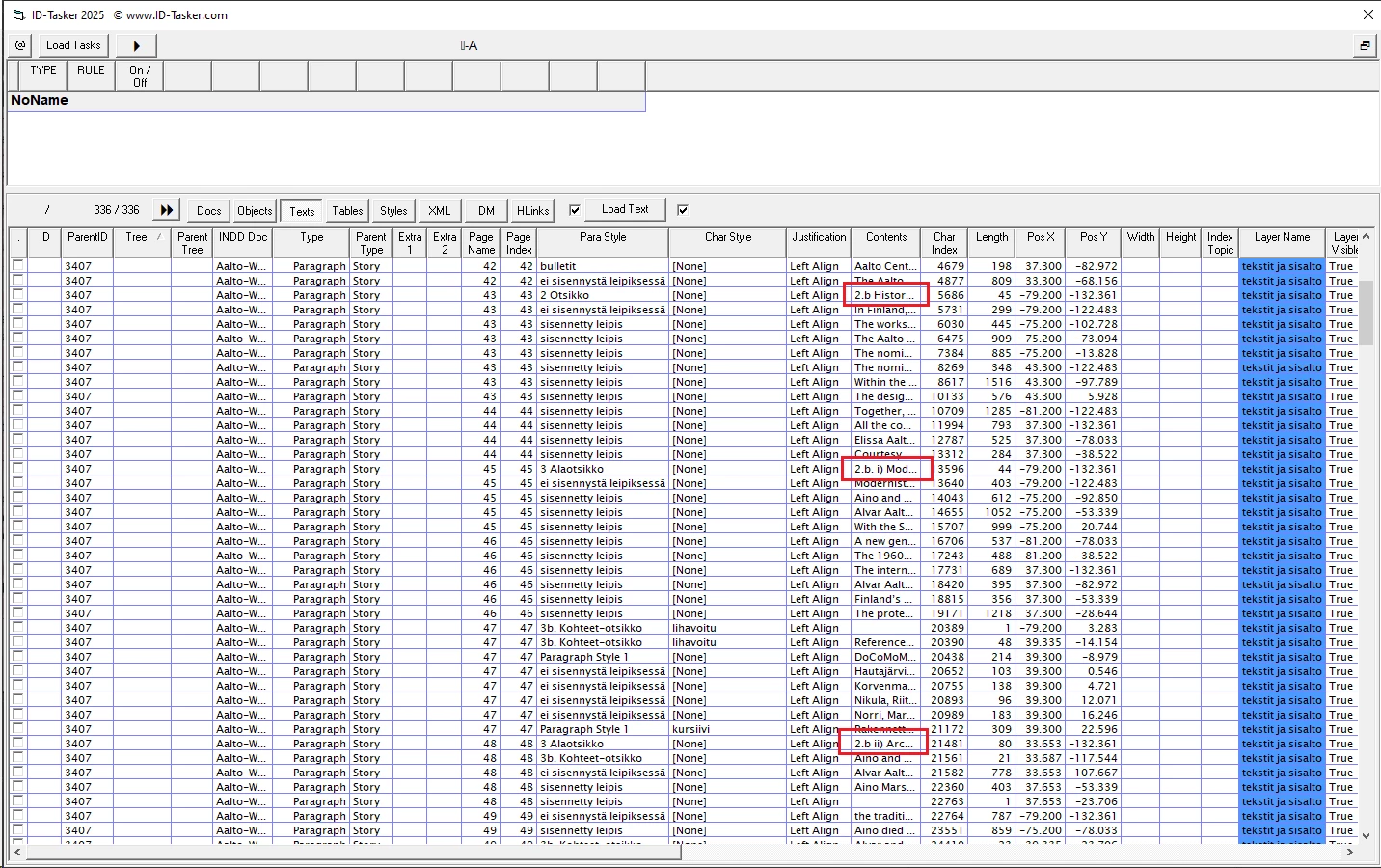

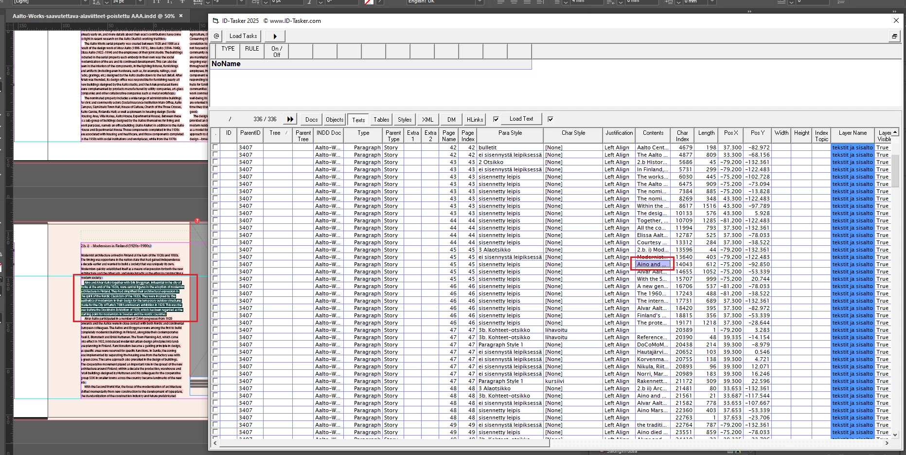

1) text contents of a selected Story - of course, you can load ALL stories / texts from your document:

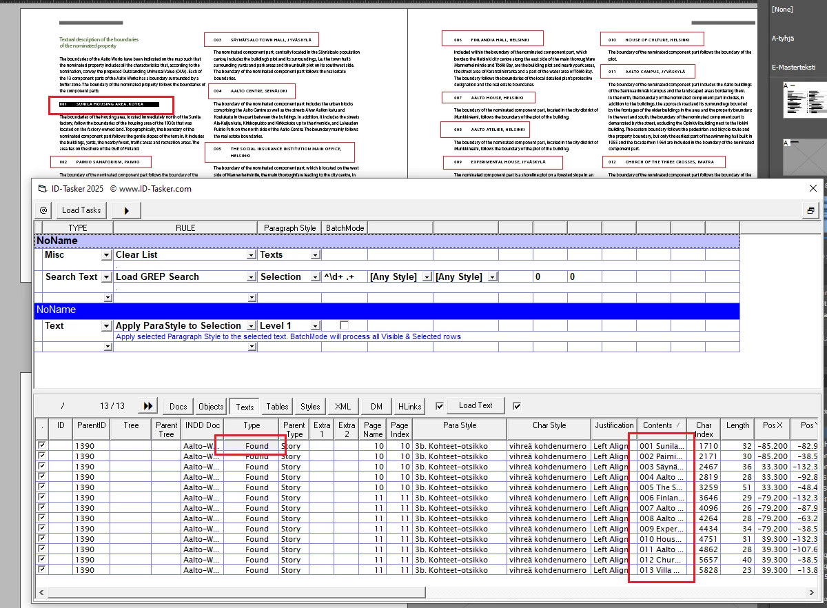

Marked in RED - few paragraps that have some kind of numbers at the beginning.
You can use up/down arrows to navigate through the document - and my tool will automatically highlight corresponding text in InDesign - in order to not make screen "jumpy" - you can use Ctrl/Shift/Alt and their combos to: zoom 100%, zoom on spread, zoom in/out:
As you can see - all texts are "reduced" to only few characters per line - so on this screen alone you can see few pages of text - It's not my document so I'm not showing more - but you can make column CONTENTS much wider to see more text.

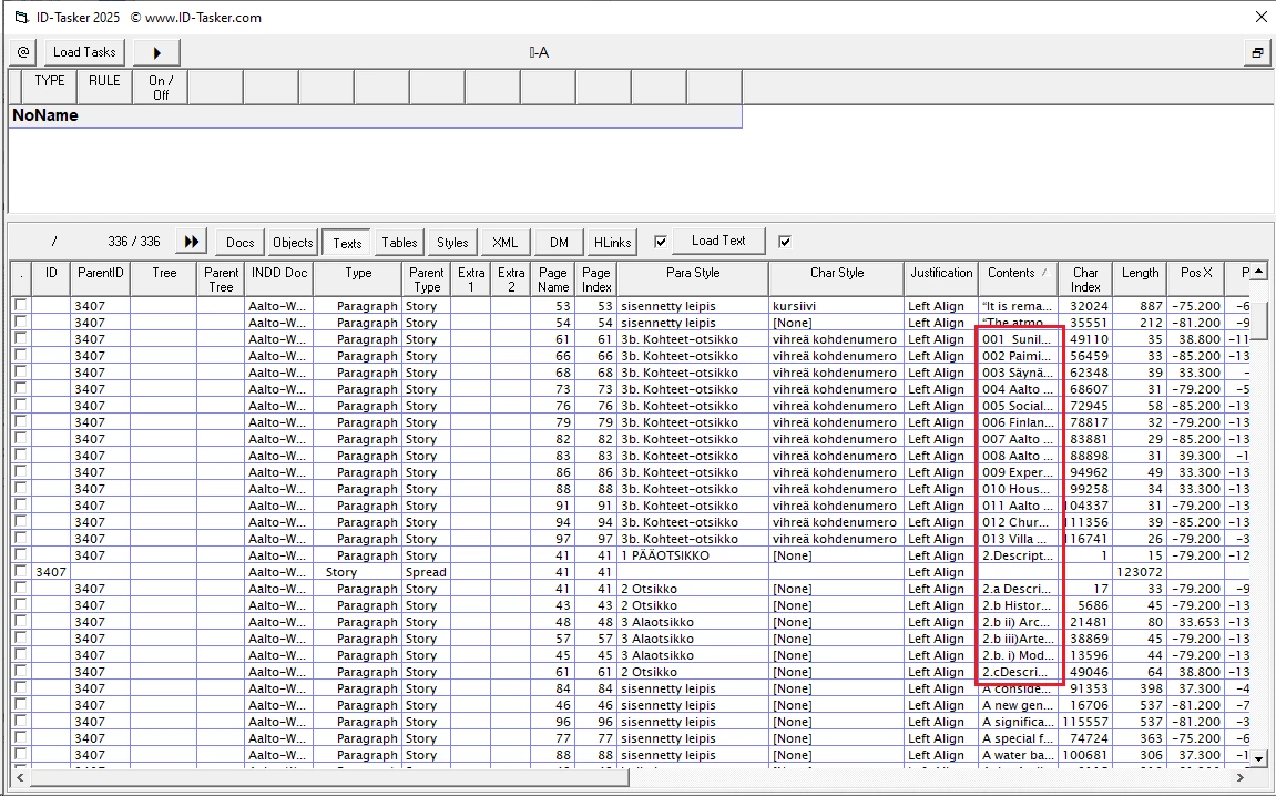

Now, here is the best part 😉
You can SORT by column Contents - to get something like this - all "relevant" paragraphs together - so no need to jump all over the place:
For Romans / letters filtering would need few extra steps - or you could use GREPs I've provided.

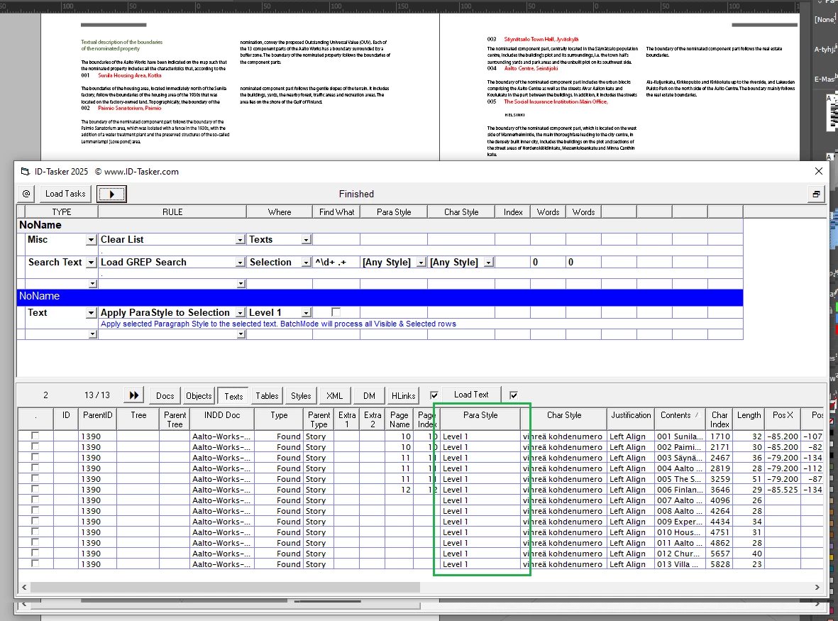

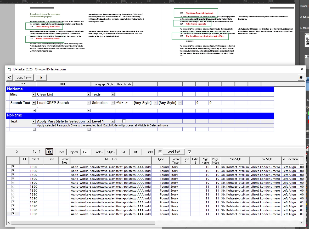

For numbers - it could look like this - effect of the first Task:
Only paragraphs that meet our criteria are loaded.
And after applying "Level 1" ParaStyle - effect of the second Task - marked in green:
(yes, texts shifted - but it's just a sample with a lot of local overrides, numbers are in black because they already had CharStyle applied)
And after executing again 1st Task:
You can see that "Level 1" ParaStyle is applied.

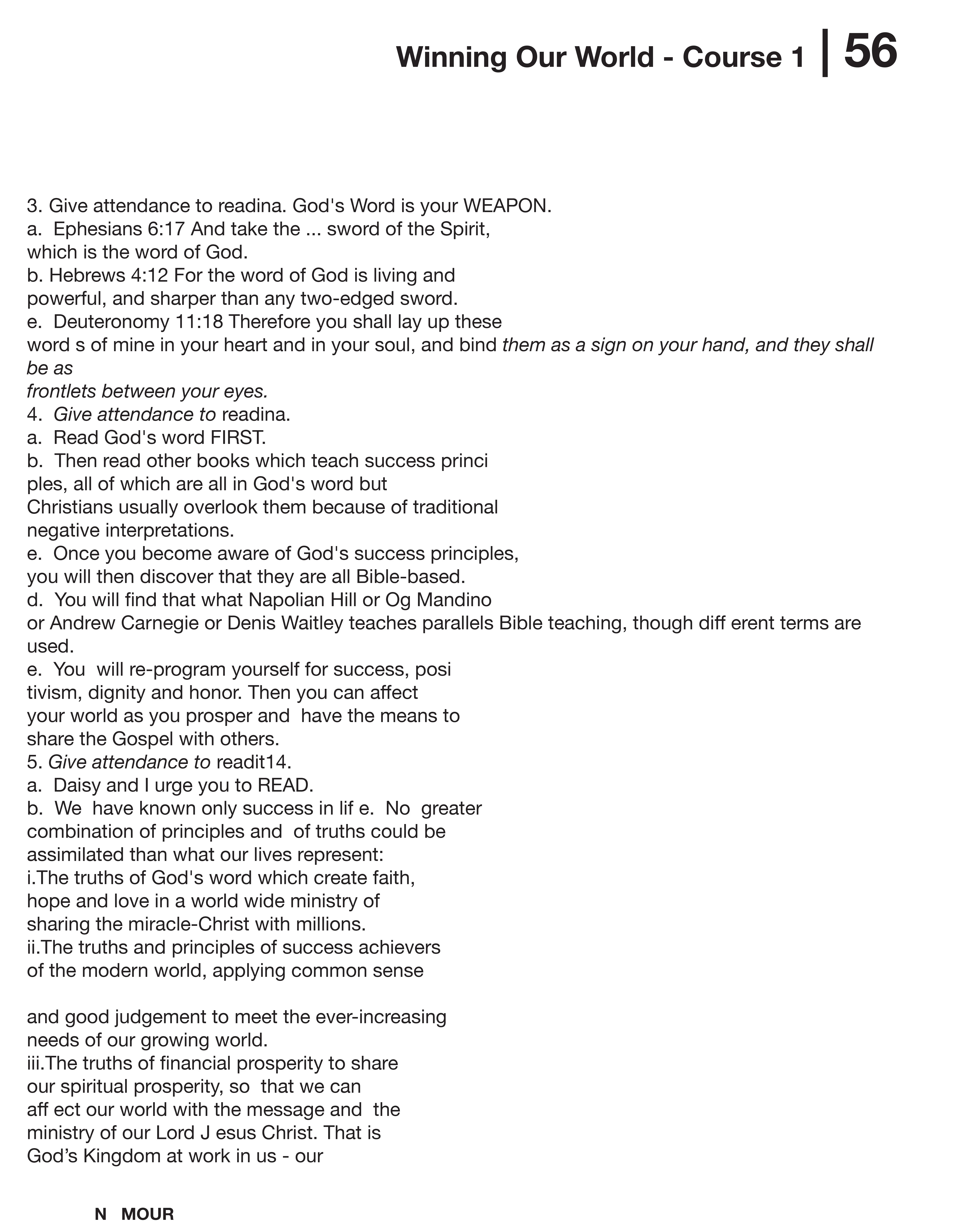

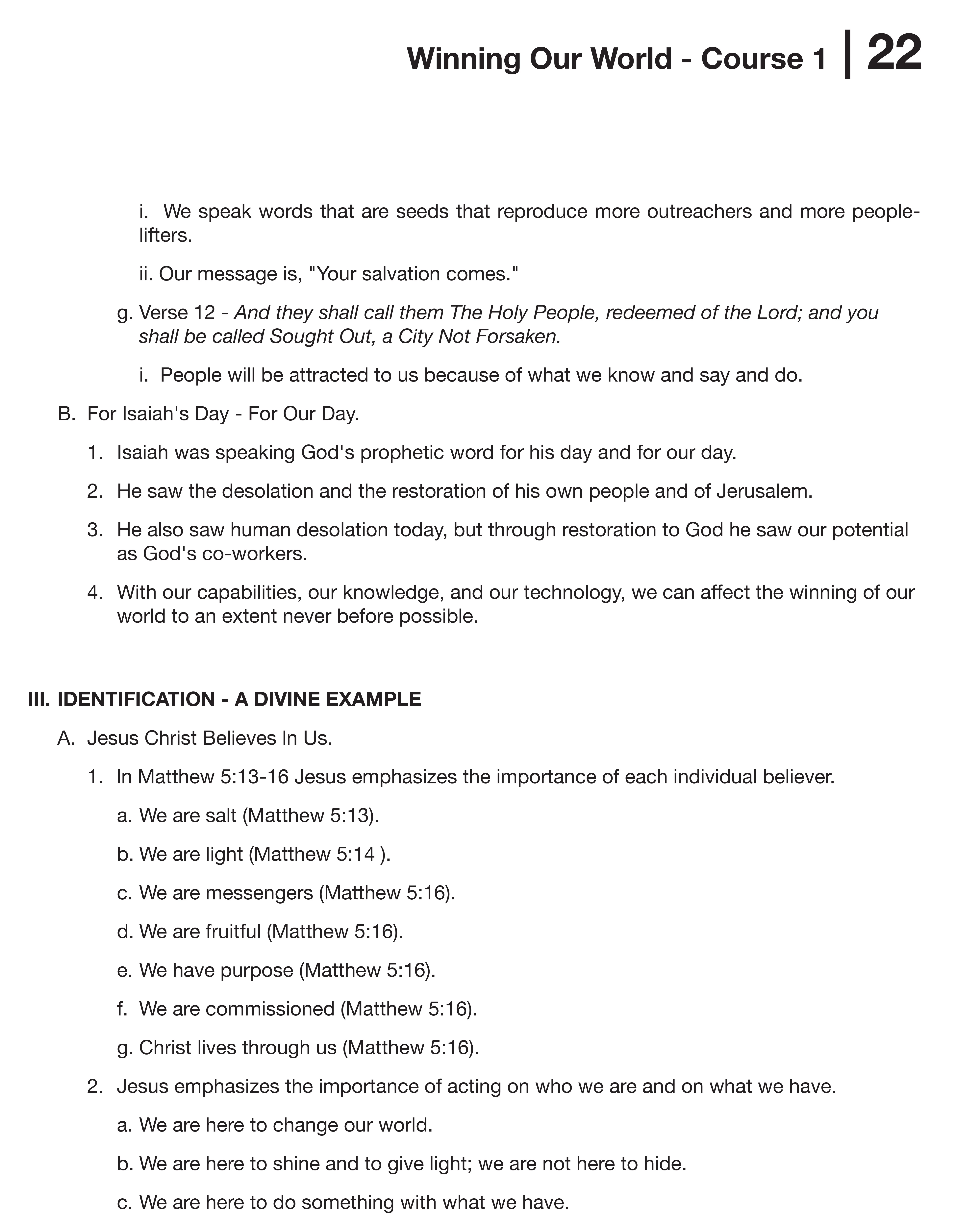

Hi Robert, thank you for your help. Here is a before and after of what I am working with. They are not the same pages but a good representation of what I'm trying to achieve. On Page 22 I've gone through and created the outline format line by line using paragraph styles. Page 56 is the PDF conversion to InDesign in it's raw form using MarkZ software.
