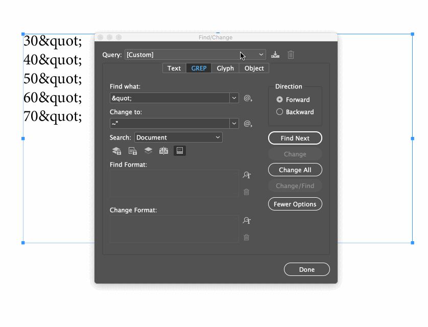

Hi all! I have a large set of data that is generated online. What I get is something like this:
30"
I need to replace that html code """ with the inches symbol.
I know how to create the inches symbol in InDesign. But I want to do a find/replace. How would I do this? Currently I have to go through the entire document and type in "control    shift    quote marks" which is very tedious. Any ideas? Thanks! Oh, I'm on a Mac using InDesign 15.0.

Hi Julie:
Is this what you need? If so:
Find "
Change to ~"
~Barb

Thanks for the quick response and for taking the time to make the video. That's great. However, when I do what you did... I get quotation marks... not inch marks. What am I doing wrong?
DigitalChickster
November 22, 2019
OH! I figured it out. I didn't add the tilde before the inch marks... when I did, that made it work. Thank you so much!
