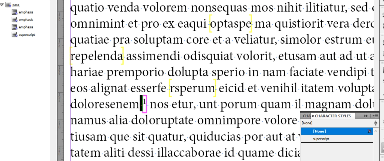

Find text with both formatting and non-formatting to replace
  • April 21, 2019
  • 733 views
With the above screenshot, I need to remove the space before superscript text. I'm a beginner in coding such, could someone suggest a code to replace?
Correct answer Manan Joshi
Try the following code
app.findGrepPreferences = null
app.findGrepPreferences.appliedCharacterStyle = "superscript"
var a = app.documents[0].findGrep()
while(b = a.pop())
    var idx = b.index
    var con = b.parentStory.insertionPoints.itemByRange(idx - 1,idx).contents
    if(con == " ")
    b.parentStory.insertionPoints.itemByRange(idx - 1,idx).contents = ""
app.findGrepPreferences = NothingEnum.nothing
Edit :- Incorporated the suggestion made by Peter Kahrel​ in the comment below, we can also change the algorithm as suggested in that post. However the code in this post will also work fine
-Manan
May 10, 2019
It works fine now, considering the insertion points with XML tags.
app.findGrepPreferences = null;
    while(b = a.pop())
        var idx = b.index
        var con = b.parentStory.insertionPoints.itemByRange(idx - 2,idx-1).contents
        if(con == " ")
        b.parentStory.insertionPoints.itemByRange(idx - 2,idx-1).contents = ""
Thanks Peter, and special thanks to Manan Joshi.

May 9, 2019
It's not working still, may be the insertion points referred to the XML tags!
May 10, 2019
I retested it on my end and it works, can you share a sample InDesign document so that i can see what is different at your end
-Manan
