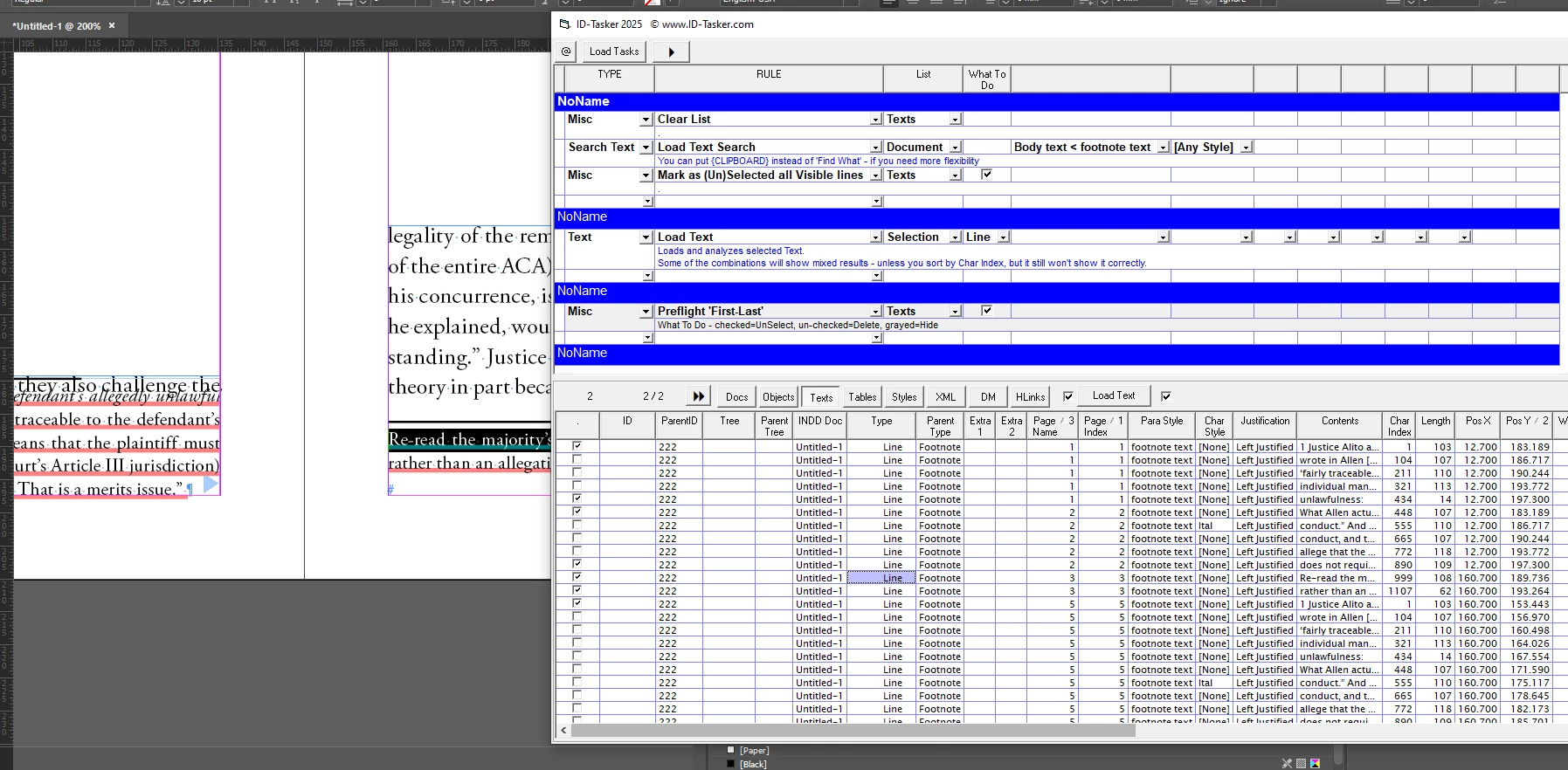

Robert at ID-Tasker
Jan 30, 2025 2:33 AM UTC
@effi2003
If you work on a PC - I can give you access to the full version of my ID-Tasker tool for some time - which will shine in this case.
Robert at ID-Tasker
Jan 30, 2025 3:25 AM UTC
1st Task - loads "general" info about Footnotes.
2nd Task - loads "detailed" info about Footnotes - each TextLine separately.
3rd Task - unselects TextLines that are in the middle of the "block" - leaving selected first and last in the "block" (*) - "block" is defined by Sort Order - in this case PAGE INDEX + POS Y + PAGE NAME. Last column in Sort Order - PAGE NAME - is used to recognise a "block" - the same values, which, in this case, means the same page.
(*) Right now "Preflight 'First-Last'" rule leaves both first and last lines selected - just need to modify it to leave selected only first or last.
Of course, first lines of each Footnote can be included as well.

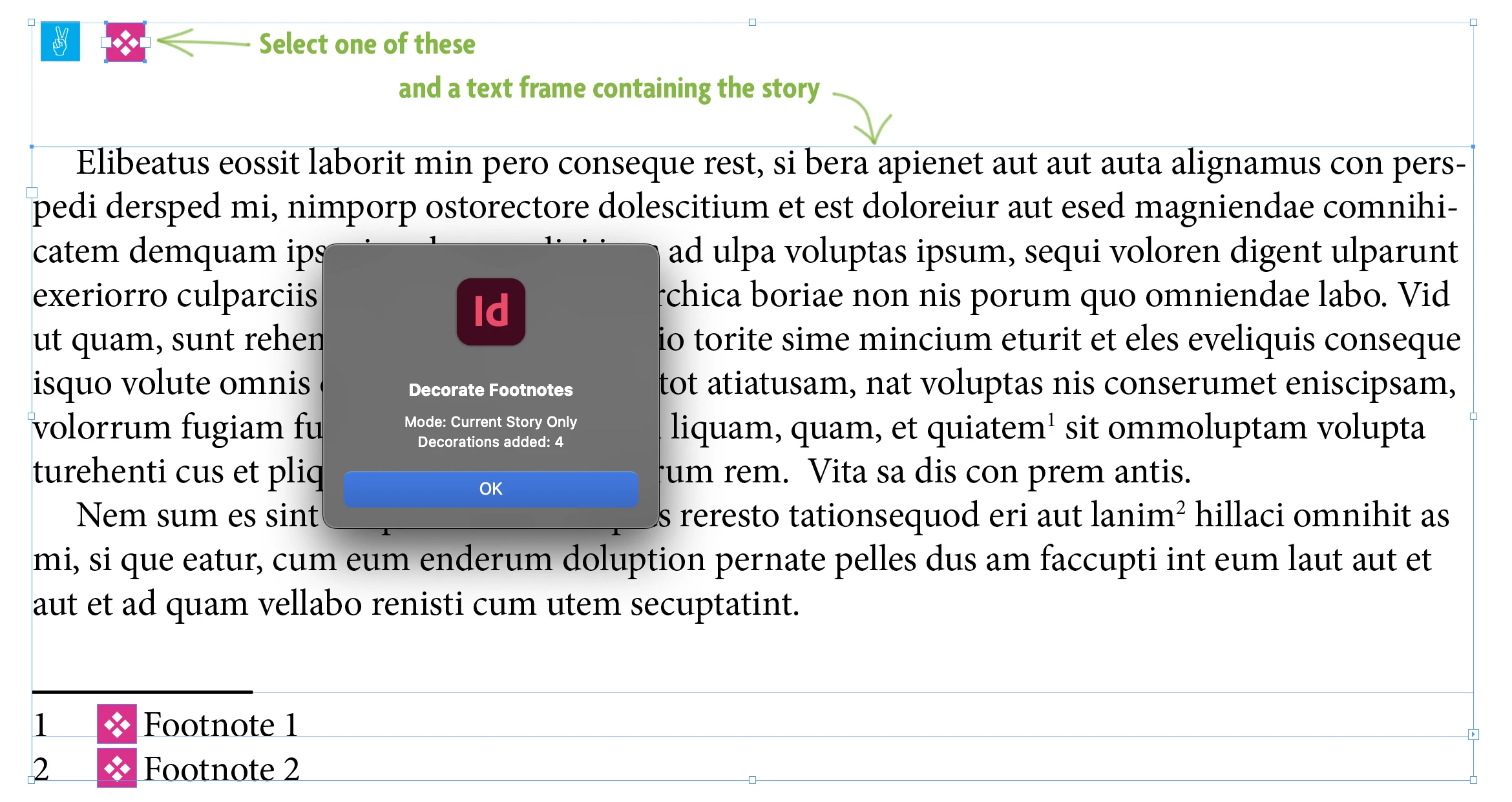

Jan 30, 2025 1:01 AM UTC
Hi @effi2003, I have written a script along the lines of your script above, but I didn't use its code because it was strange and very incomplete. Perhaps this will give you an idea of some approaches to your problem. I've made it somewhat configurable via the `settings` object in the code.
There are quick instructions in the code, but let me know if you don't understand anything or if it has bugs. 🙂
- Mark
P.S. I have added my demo.indd file which you can try the script out with, if you want to first match my result below.

Edit 2025-01-30: to add demo.indd and screenshot.

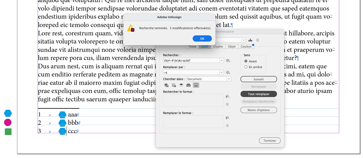

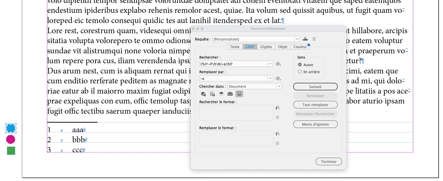

FRIdNGE
Jan 30, 2025 2:14 AM UTC
… Hmm! Copy in the Clipboard the Page Item to be Pasted and Play this simplistic Grep Find/Replace …
… Grep F/R you can obviously translate to a Script if you want:
// Copy in the Clipboard the Page Item to be Pasted and Play the Game! …
app.findGrepPreferences = app.changeGrepPreferences = null;
app.findGrepPreferences.findWhat = "(?s)^~F\\h\\K(~a\\h)?";
app.changeGrepPreferences.changeTo = "~c ";
app.activeDocument.changeGrep();
(^/)  The Jedi
