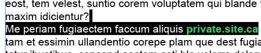

Hi All,
Trying GREP code:
\s+.+\.ca
\s -- space
.+ --- one or more character
\.ca --- end with .ca character
And also try zero or one time(short match)
But I cannot find the solution. Very urgent request. Please help.
Please refer the attachment for more clarifications.
