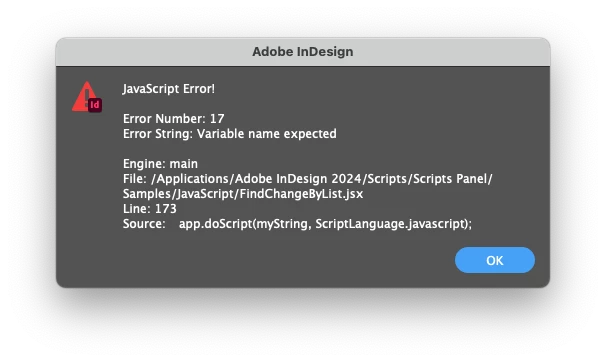

I create a monthly magazine in InDesign, and set it all up to build a Table of Contents at the end.  Of course, a lot of formatting changes need to be made to the ToC after the fact, so I set up a BUNCH of grep find/change functions.  But I wanted to try and set it up to be a one and done type of thing, so I set up the findchangebylist.txt file using the Record Find Change script written by Martin Fisher.
When I ran it, it appeared to run some of the find/changes in the script, but definitely not the first one, and then I got JavaScript Error Number 17.  I removed the commas from the beginning that were created by the recording script, as suggested in this post, but the error persisted and didn't change.

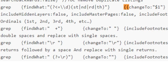

Had a quick look and saw two opening {{
Any reason? Sorry I haven't taken a closer look at this it just jumped out

Yeah, found it yesterday 😉
Let's see if it will work for @aDavidAlan
Feb 29, 2024 3:08 PM UTC
So you did! My bad - you are correct I guess.

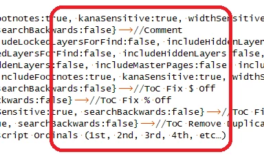

At the end you forgot to add "//" before your comments - you've done this for the first few rows:
aDavidAlan
Feb 29, 2024 12:37 AM UTC
That doesn't appear to be the problem.  Removing those tabs didn't change the error, so I suppose they probably weren't needed.

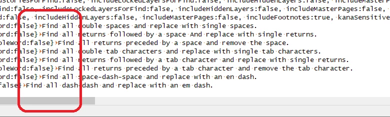

OK, I've re-read the "manual" for the list - and it looks like everything after the tab should be treated as a description.
There is only one thing you could do - run one line at a time...

there is double "{{"
