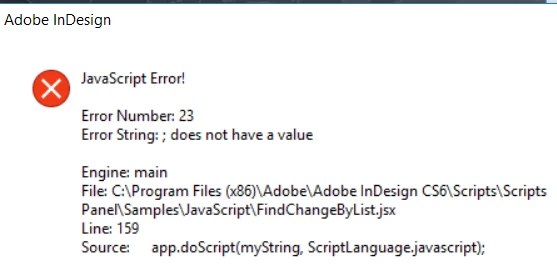

Hello!
MyFindChangebylist script for IND CS6 has an error. Where can I find a new copy of the script to replace my existing copy?
Sue

    Hi cbishop01,
    Thanks for the link. I found the script and overwrote the copy I have. Unfortunately, I got the same error as I posted to Steve. This is more challenging then my level of expertise : (
    December 6, 2016
    Is your "FindChangeList.txt" inside the folder FindChangeSupport?  You will more than likely have to replace that script and then restart indesign.  Thats what i had to do.  ALso Did you edit your FindCHangeList.txt before the Error started?  Also did you download the  Download the InDesign Supporting Tutorial Scripts (ZIP, 94K) file? from the above address?  Just unzip it and replace the Script/s that are bad.  If you did that already maybe have the Moderator move this to the Scripting portion of the forum.  THey would be able to help you out better.

    What's the error message?

    Hi Steve,
    This is the error I get when I run the script:
