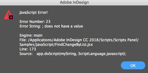

I'm getting this error when i run the script:

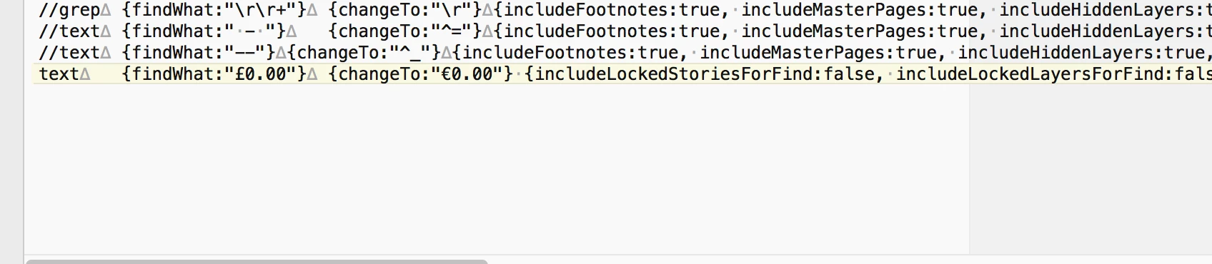

turn on the invisible characters when editing the txt. I am using TextWrangler. Most probably you are missing a tab before the last brackets   [TAB HERE] {includeLockedStoriesForFind... (see attachment). I am able to reproduce your error.
Thx Stefan
