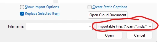

    Searching outside of InDesign works fine. And in InDesign, if “All Files” is selected (no filter), it works fine (see my reply to Abhishek).
    But any filter, including the default(?) “Importable Files”, doesn’t seem to initiate the search process in my case. However these filters works fine if I switch to “All Files” and back, and don't reset search window field.

    I don't remember if I myself have switched the Placed file type from "All files" to "Importable files" at some point, or "Importable files" is the default setting of ID 20.5, which has also "migrated" to ID 21. With the selected "All files" type, everything works as it should.
    But with the "Importable files" mask something weird is going on. 1) nothing happens if I start search initially or after search field cleared with “x”. 2) But if I switch filter to “All files”, searching some files (without placing) and then switch filter back to “Importable files”, search works fine.

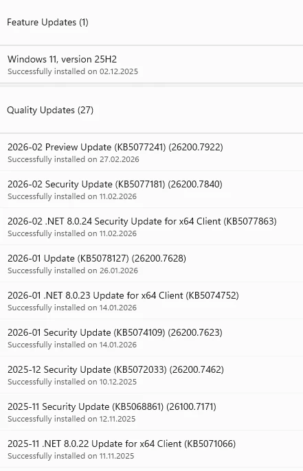

    I think someone else posted about this a while back. It’s not an issue for me here so make sure that Windows is fully updated to 25H2 with all optional updates.
    Mike Witherell
    Feb 26, 2026 4:34 PM UTC
    What is your latest Window Update installed?

    Since I was going to move to ID 21 I didn't pay attention to when the problem appeared because I don't use search too often.
    I suspect it could be the .NET 8.0.23 update in January.
