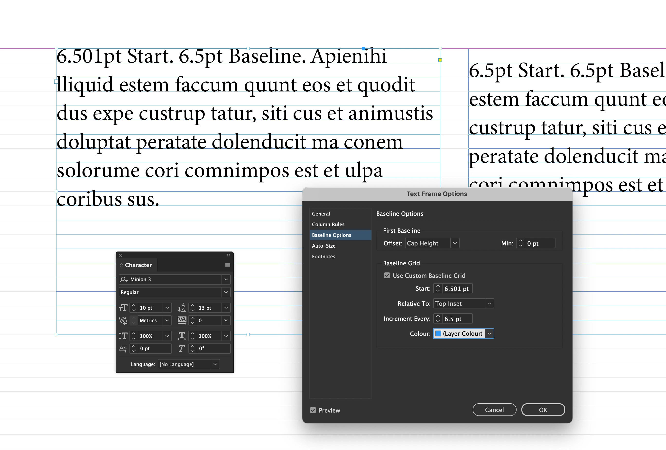

Here's a weird quirk.
  1. If I set the font size to 10pt
  2. Define the First Baseline, Offset to Cap Height
  3. I can then Fit Frame to Content through the fitting options

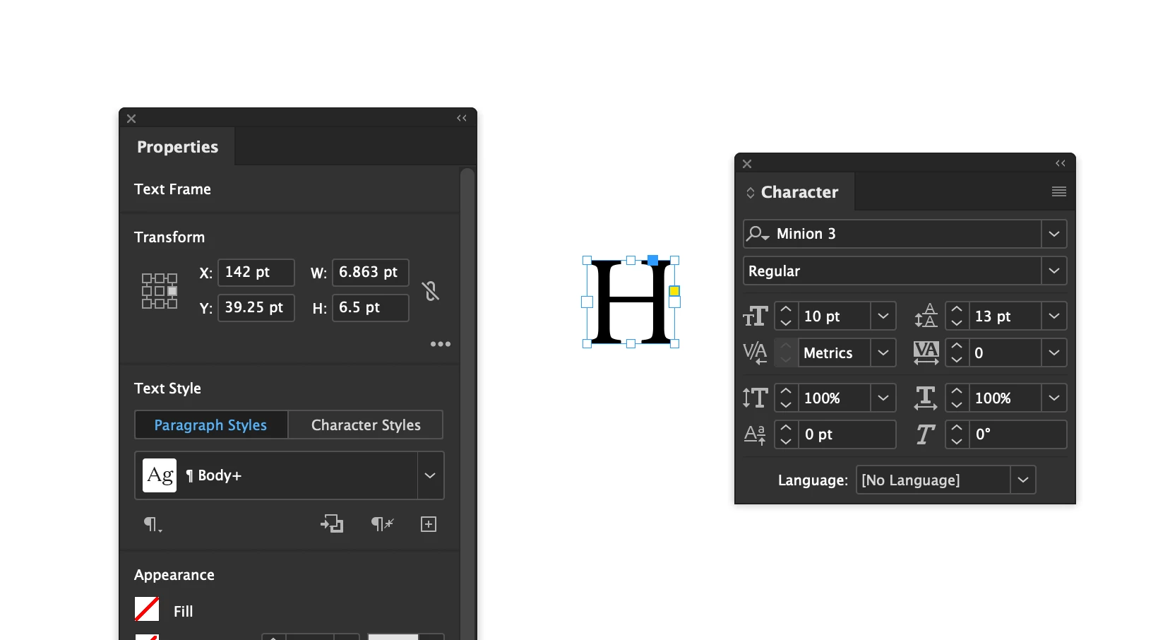

  4. The properties window would tell me the height of the text frame and thus cap height is 6.5pt (for this font, Minion 3). Could also be thought of as 65% of the em square.
Now:
  1. If I set my text to be aligned to the baseline grid
  2. Then set a custom baseline grid with a start of 6.5pt
  3. The text doesn't align within the start value (referenced by the red square) and instead skips down to the next baseline.
Workarounds:
  1. Set the First Baseline, Offset to x Height or Fixed
  2. Increase the start value by a nominal amount. For example 6.501pt would work.
This appears to be a bug to me, does anyone have any insight into this?

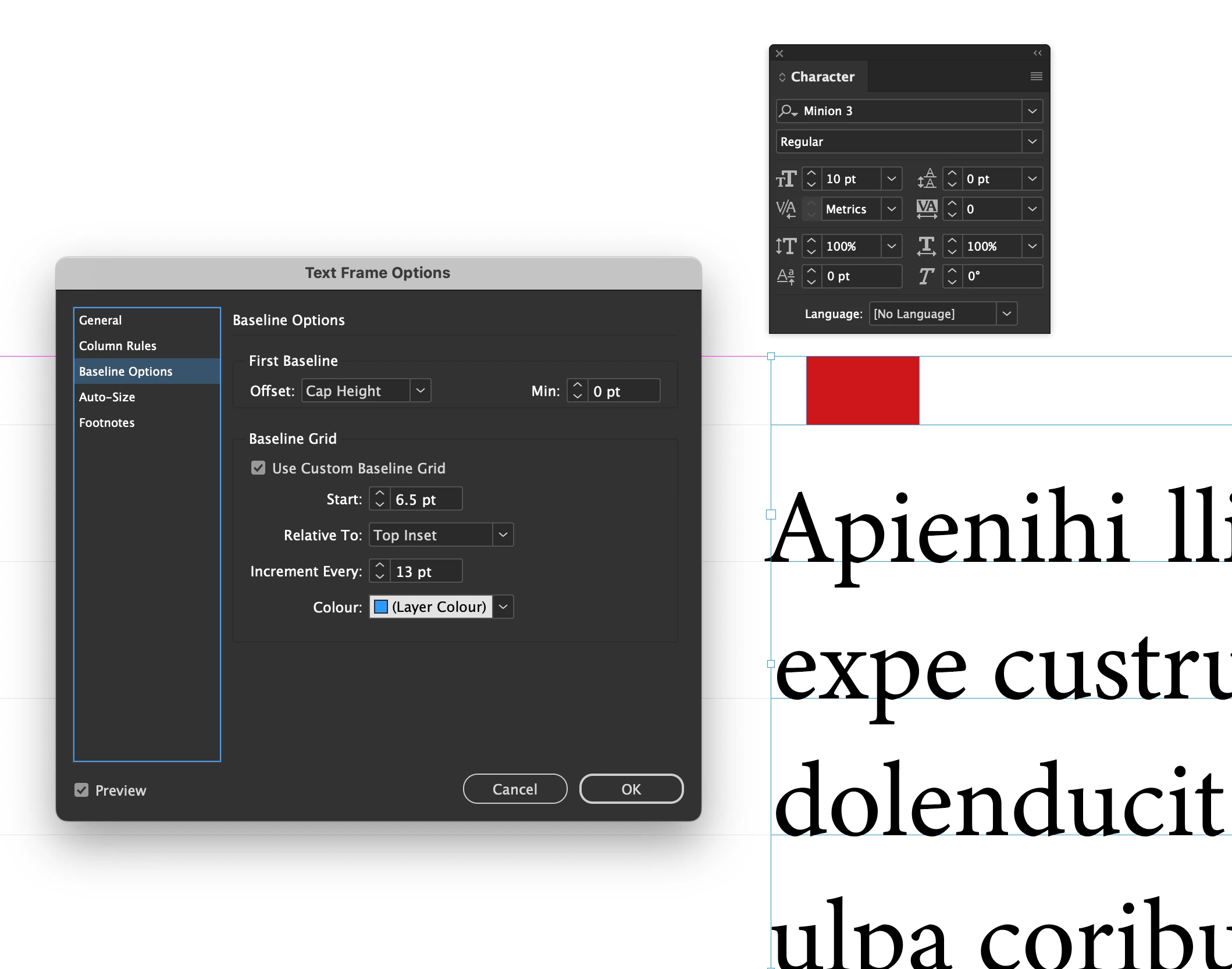

Sep 27, 2024 3:37 PM UTC
Hi @Ciaran25473599uu11 , Looks like your text’s Leading is set to 0, try setting it to match the Baseline Grid:
Sep 27, 2024 3:52 PM UTC
Hey Rob! Thanks for responding. In the original test, the baseline does match the leading—though I can see you'd have to cross reference the two images.
In the screenshot below, this showcases the oddity. Here's a side by side comparison. Both are identical expect the 'Start' value is 0.001 larger. As a result, it no longer drops down a baseline.
  1. If we set the start value to 6.501 and the increment every to 6.5. It does work correctly.
  2. If we set the start value to 6.5 and the increment every to 6.5. It drops down one baseline, but otherwise functions as expected.
When I say correctly, this is because the leading is set to 13pt.
I'd guess from this, the problem is in the start value and somehow there's a 0.001pt addition somewhere.

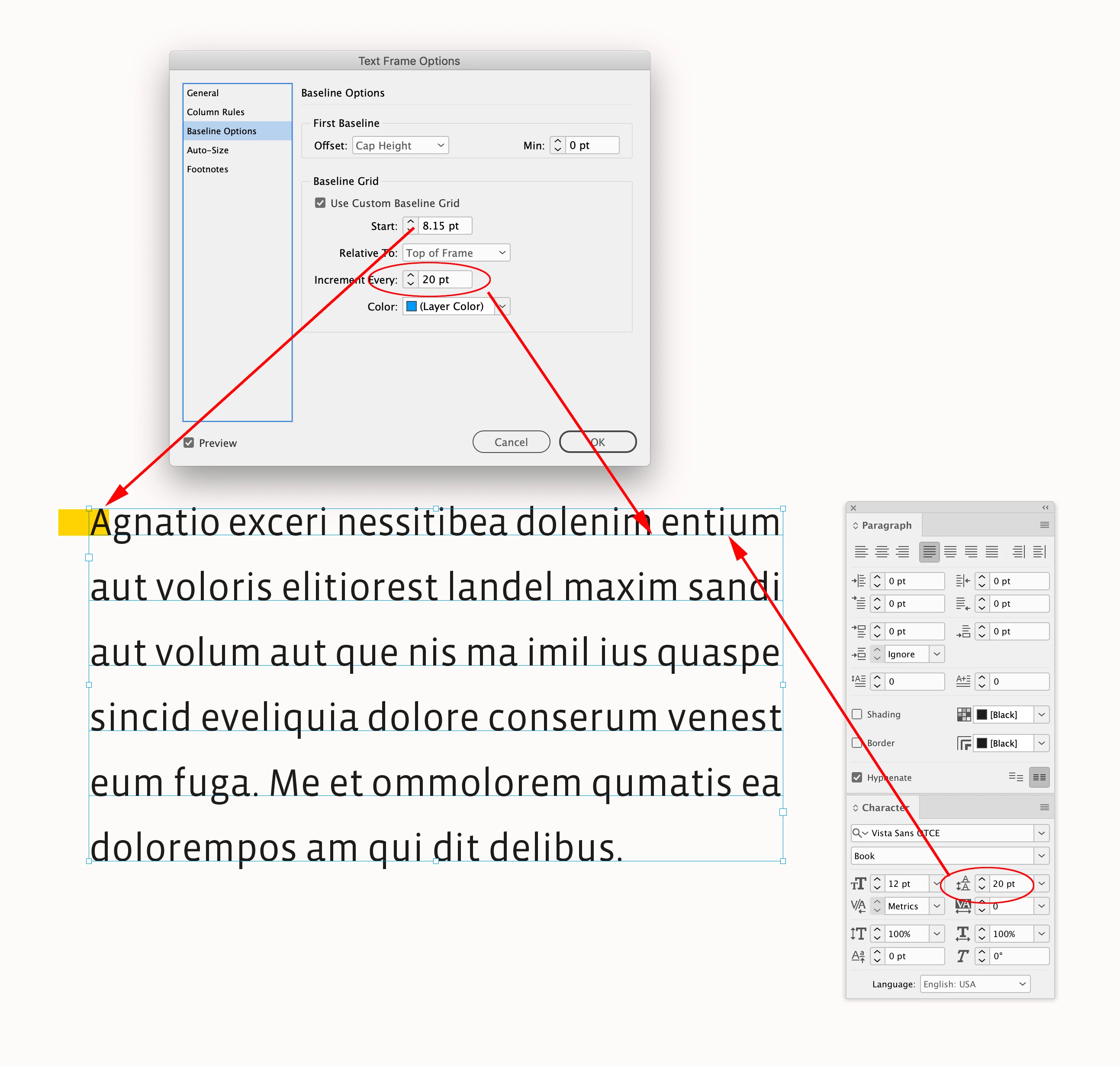

Abhishek Rao
Sep 27, 2024 2:05 PM UTC
Hi @Ciaran25473599uu11,
Thank you for sharing the detailed breakdown of the issue. It seems you've encountered an odd behavior with the First Baseline Offset and the baseline grid alignment.
The issue could indeed be linked to the precision of the Cap Height value versus the baseline grid, which might cause the misalignment you're seeing. Your workarounds (setting First Baseline to Fixed and adjusting the Min value or slightly increasing the grid start value) are valid and often help when dealing with such quirks.
In addition, I would recommend:
1. Ensuring that the Baseline Grid Increment is divisible by the cap height, or slightly adjusting the increment to match the font's measurements more closely.
2. You can also try adjusting the leading slightly or experimenting with different text frame settings to see if this minimizes the issue.
In the meantime, I will check this with the product team and provide you with an update. Feel free to let me know if you need further assistance.

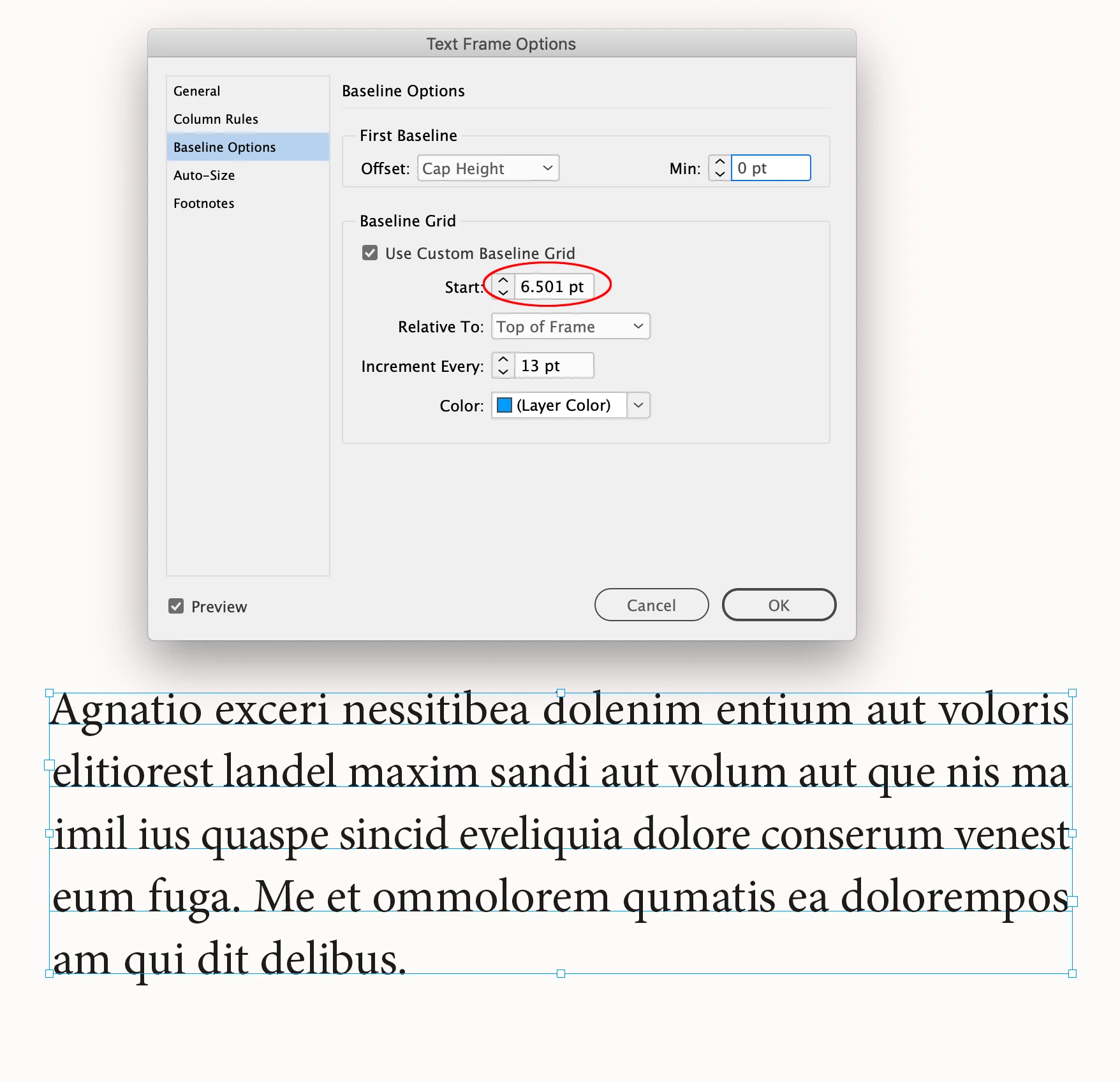

Sep 27, 2024 3:56 PM UTC
Hello Abhishek — thank you for getting back to me. Do look below, seems the issue might be in the Start value. The increment every field seems to be working correctly.
Either there's a 0.001pt variable being added somewhere.
Or!
As InDesign goes to 3 decimal places. The value could be even smaller, and it's being rounded up.
