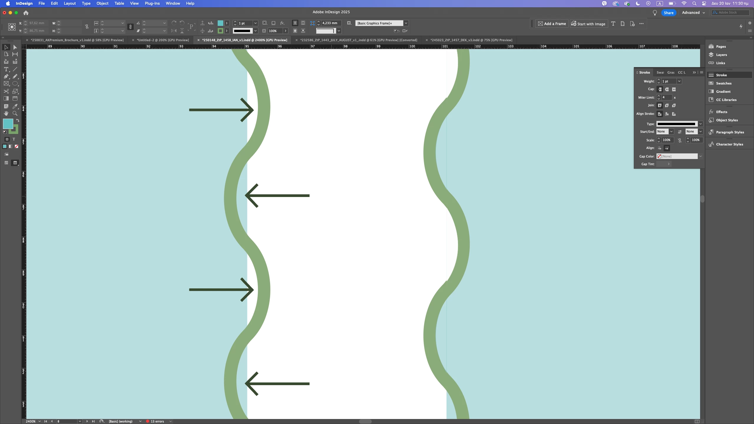

Fit fill to wavy stroke
Hello there
I im not sure how to explaine it (see screenshot).
I'd like to create a shape (f.e. rectangle), where the fill of this shape fits exactly into the curves of the wavy stroke when aplly it.
Without using Illustrator f.e. copy-paste etc..
I need this to be scaleble and 100% in indesign.

That Wavy Line stroke built-in to InDesign! It doesn't behave like anything else in InDesign. Joining paths will (unfortunately) not work in InDesign. Your only alternative is to draw it in Illustrator; then copynpaste it (using AICB) to give you a frame in InDesign. In Illustrator, you have the advantage of using a wavy line generator effect. Build it to size, then expand it. Then copynpaste it to InDesign (preferring AICB, that is Adobe Illustrator Clip Board) to get it over to InDesign as a simple frame.

It can be drawn in InDesign with either the Pen or Pencil tool...

Select the two wavy strokes and use the Pathfinder Panel to Join Paths, then apply a fill.
