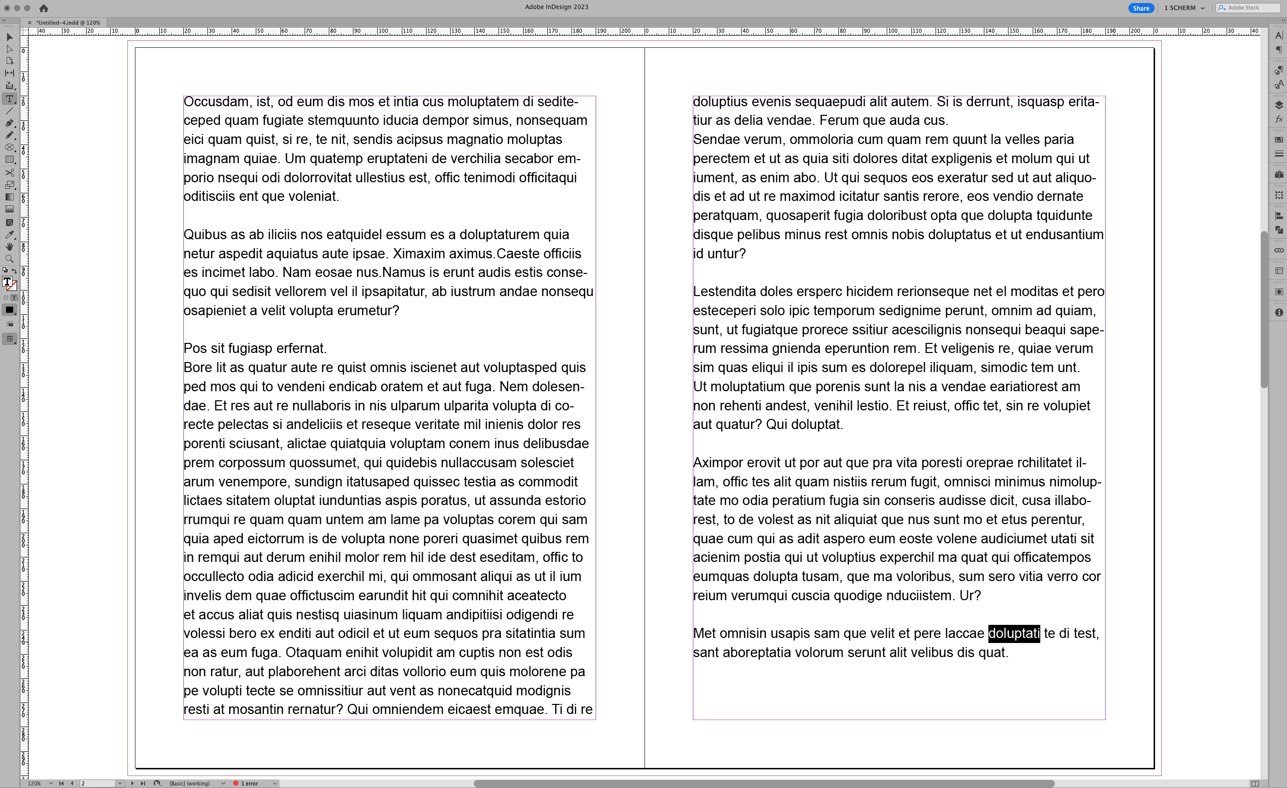

When working on a multiple spread documents i like use the 'Fit Spread in Window' view mode, to have good overview of the spread i'm working on.

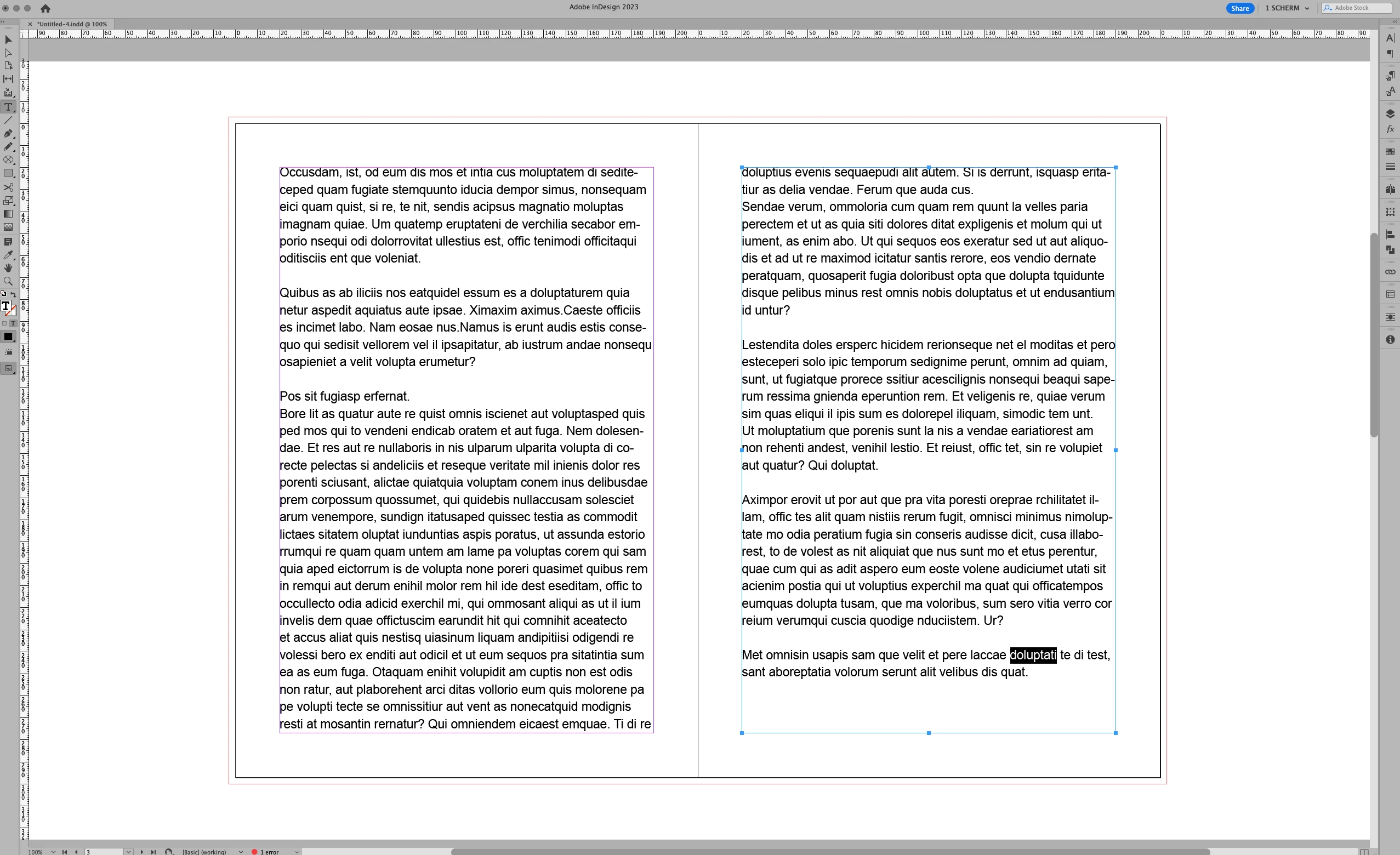

But whenever i shift some text to the next page (Paragraph return or Page Break) the 'Fit Spread in Window' view is canceled and bottom part of the previous and top part of the next spread is shown.

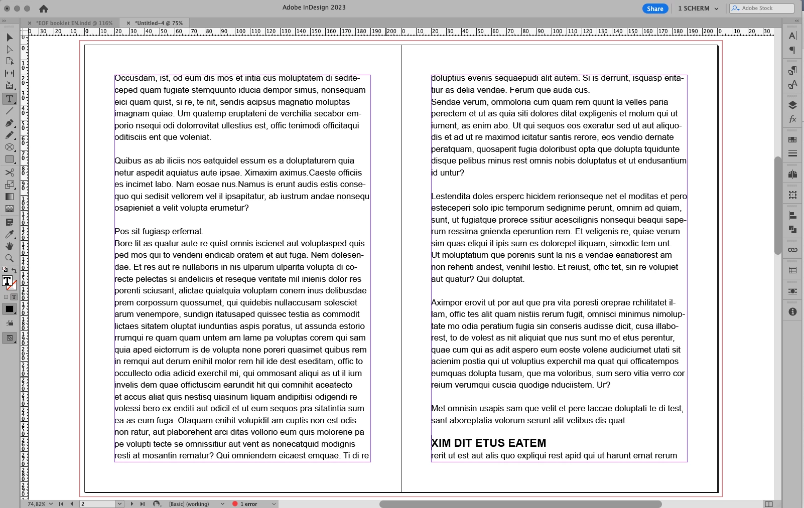

A similar thing happens when changing 'Fit Spread in Window' to 'Actual Size' when the text tool is active and the cursor is positioned in a text frame. The view then focuses on the place where the cursor is positioned an centers this spot, thus only showing part of the spread.
Is there a way to keep Indesign in the 'Fit Spread in Window' view no matter what action is being performed?
I hope my explanation is clear enough, I'll add a couple of screendumps:
1. initial 'Fit Spread in Window' view
2. view after the text 'XIM DIT ERUS EATEM' is being send to next page: parts of the 2 spreads visible.

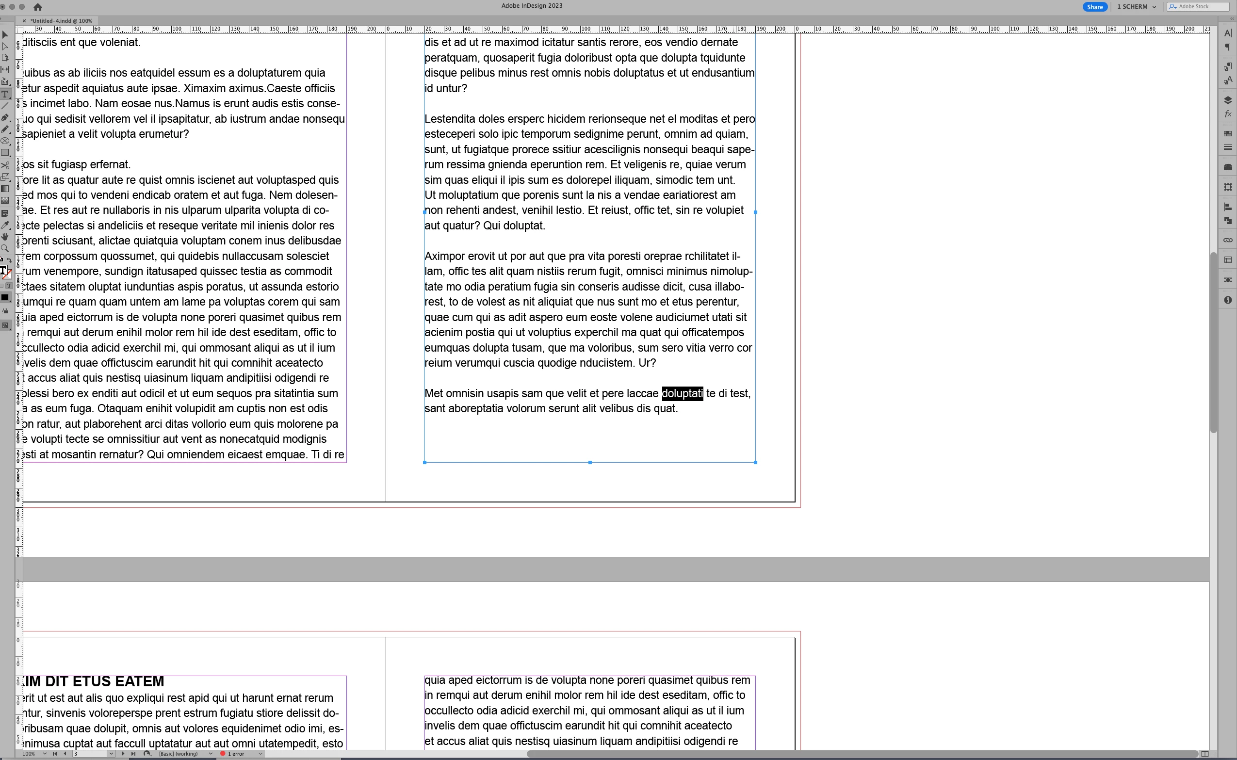

3. desired view: the next complete spread (or the previous complete spread would also be fine)
4. initial 'Fit Spread in Window' view with text 'doluptati' selected

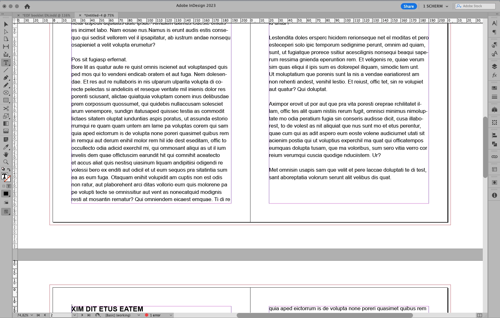

5. after changing view mode from  'Fit Spread in Window' to 'Actual Size'

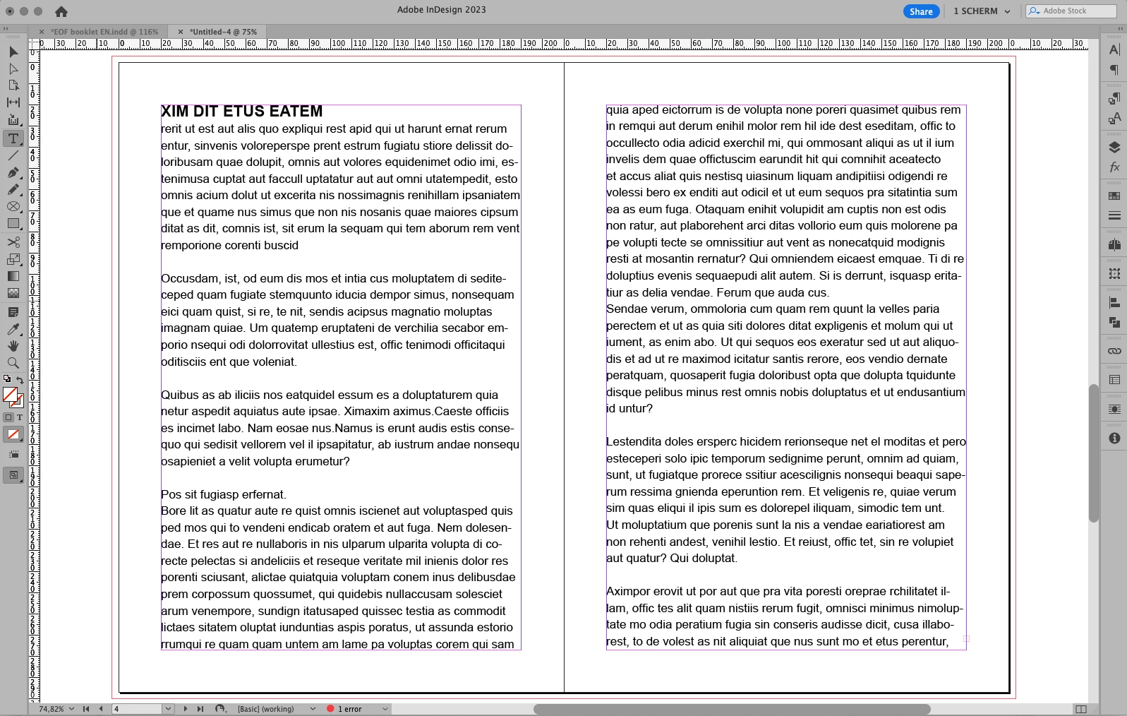

6. desired view: Actual Size but centered in the Window.
